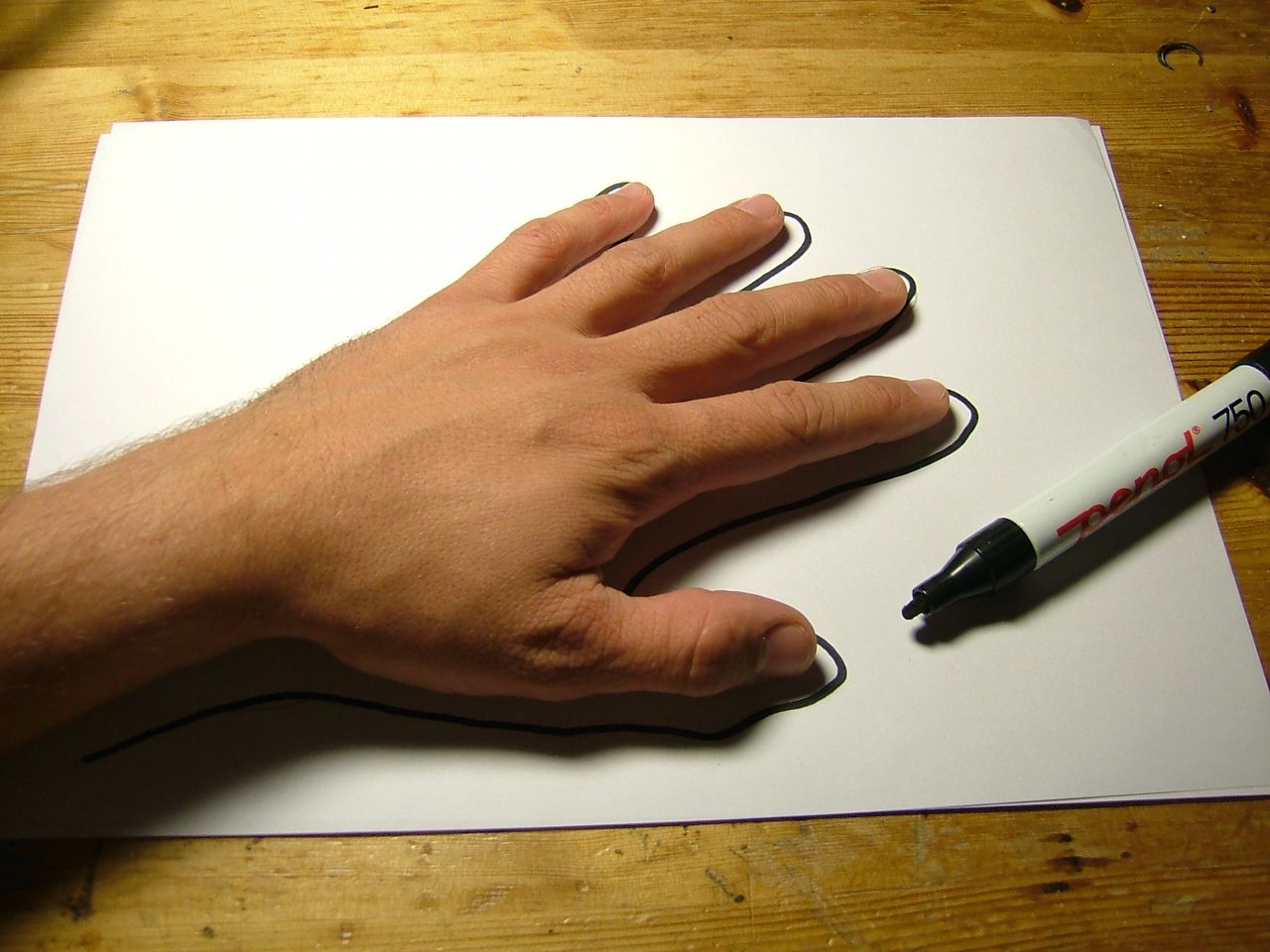

Step 2: Making the Template
First off, draw an outline of your hand on a sheet of paper.
Mark off the joints of each finger including your knuckles. If you're lazy, just print out the last picture:)
