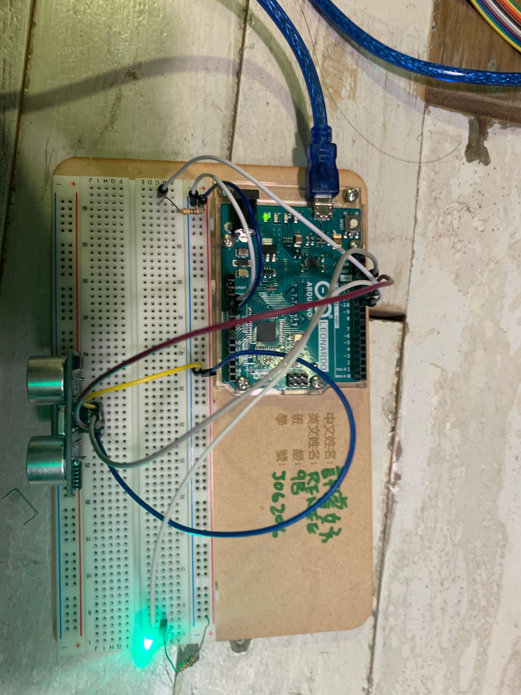

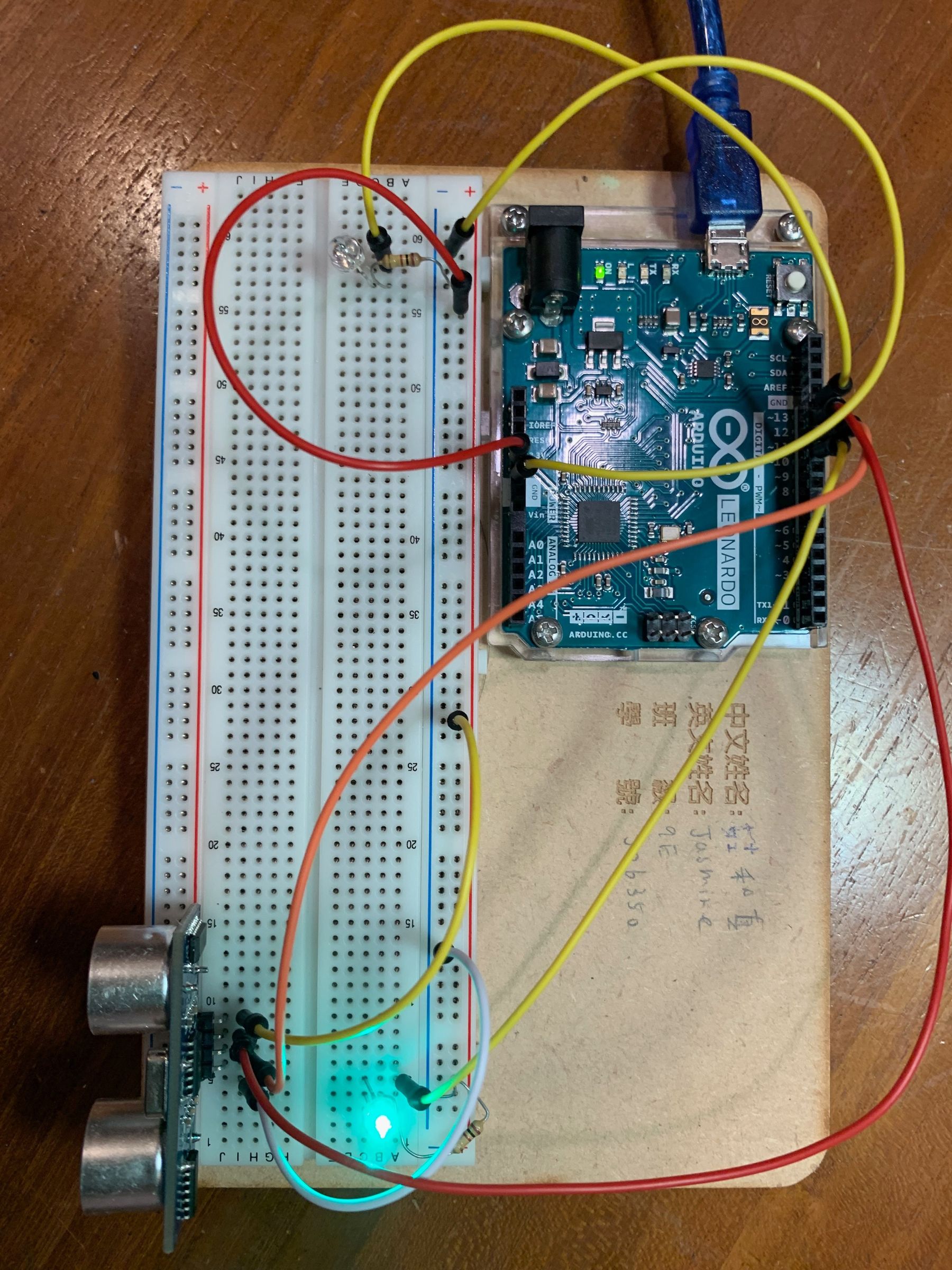

Step 2: Connect the Components

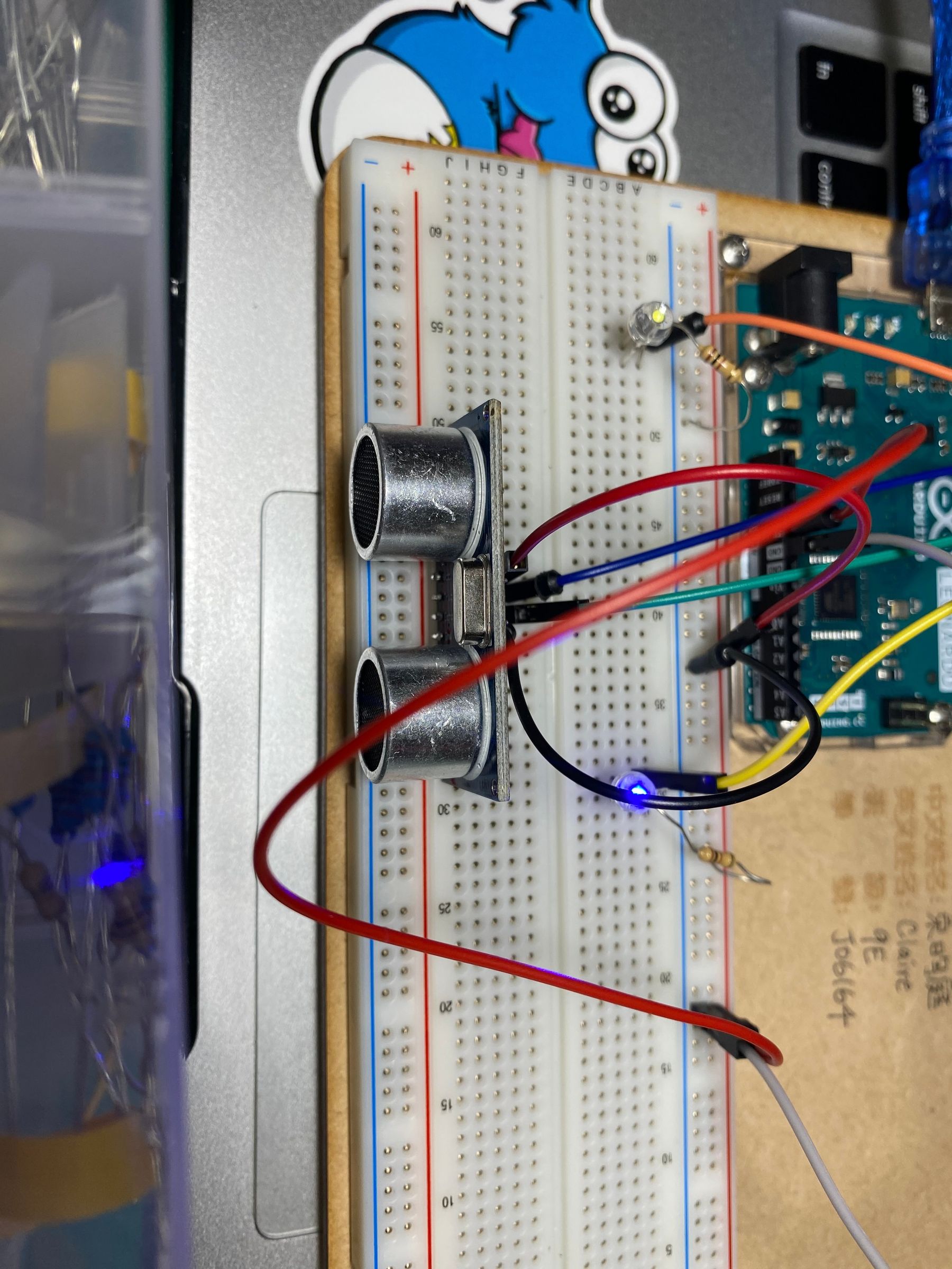

Connect the components and wires as shown in the two pictures.
Step 3: Upload the Sketch
HC-SR04 Ping distance sensor]
VCC to arduino 5v GND to arduino GND
Echo to Arduino pin 13 Trig to Arduino pin 12
Red POS to Arduino pin 11
Green POS to Arduino pin 10
560 ohm resistor to both LED NEG and GRD power rail

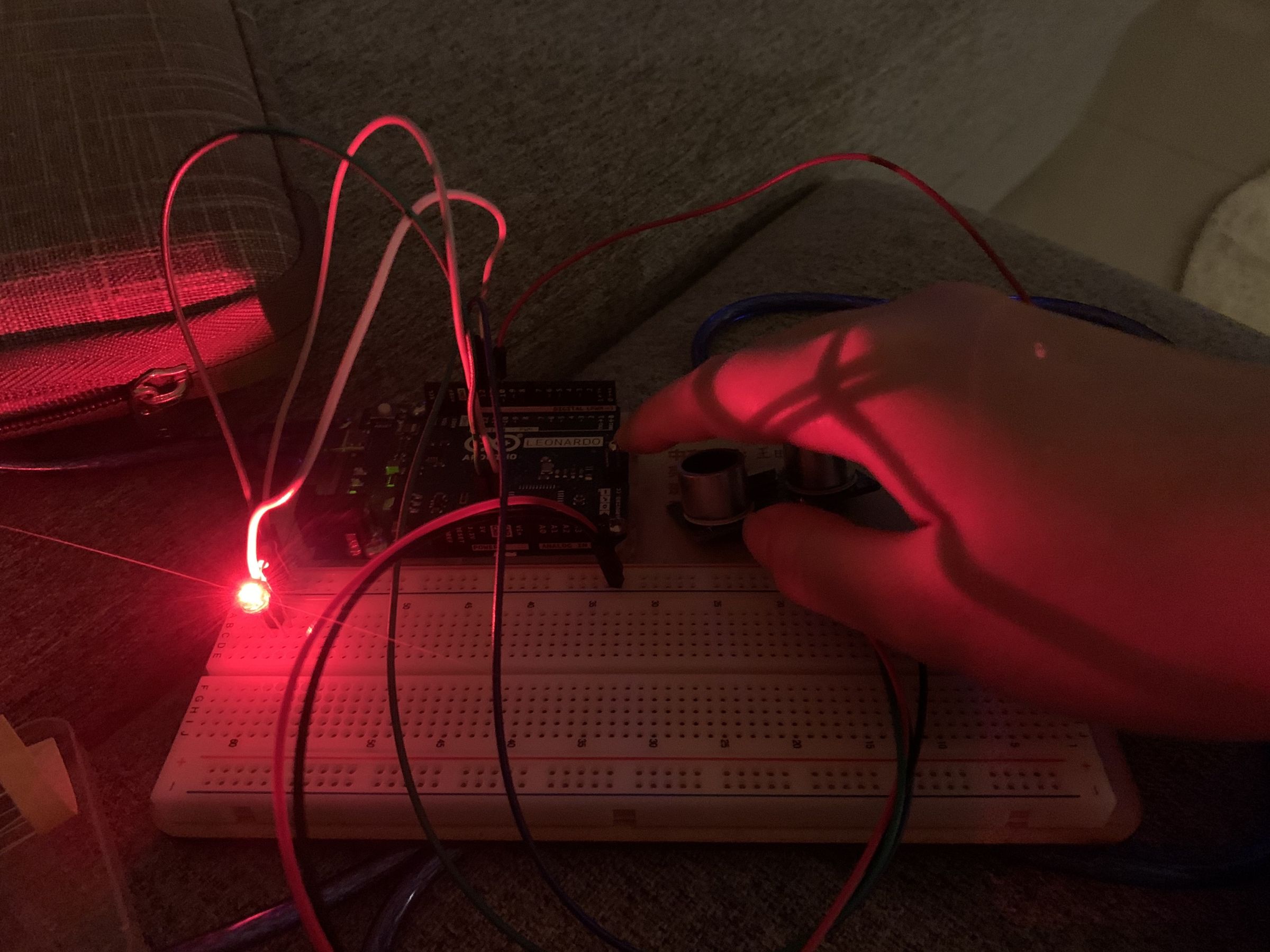

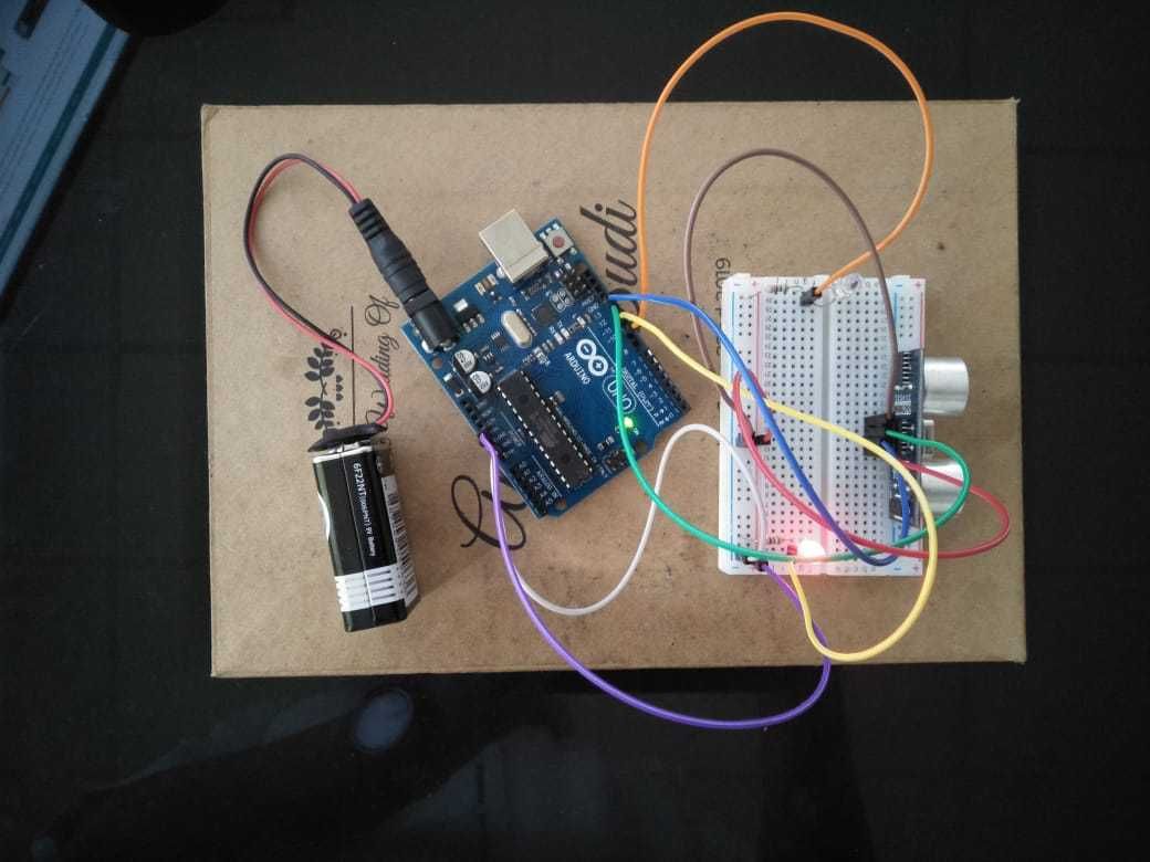

5 years ago on Introduction
Awesome. I had been struggling trying to build a working garage parking assist and this was just the sketch I needed. I did add a yellow LED as an intermediate alert. The proto works great. Transferring it now to an enclosure. I'll post a pic when completed. Anyway, thanks for posting the tutorial!

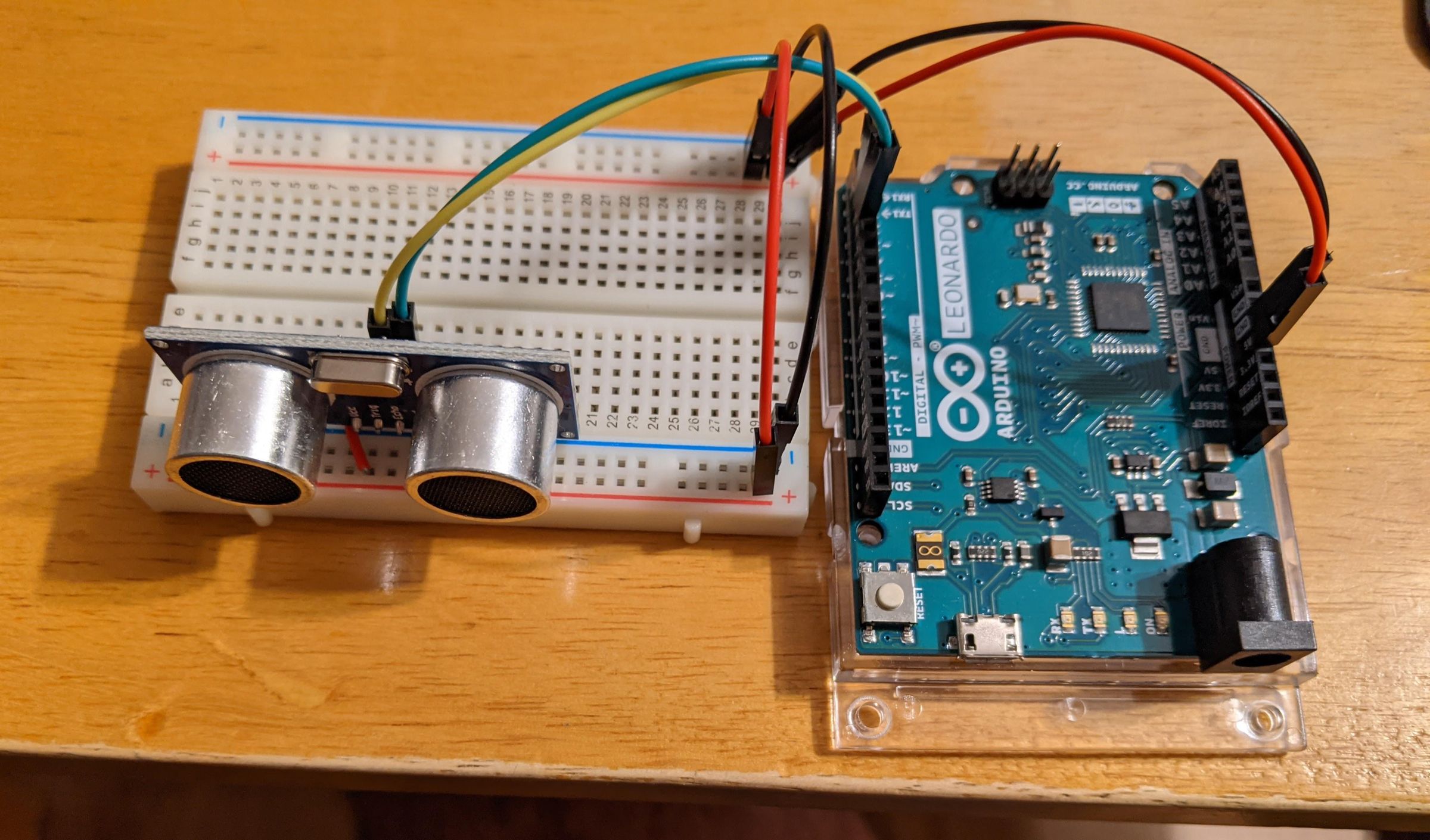

Can someone please upload the circuit diagram for this example. Thank you in advance.
