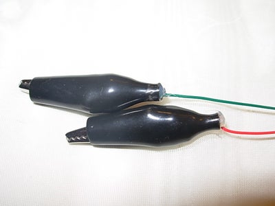

2 x Crocodile/Aligator clips

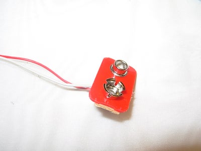

1 x PP3 Battery Connecter (I took my from an old PP3 battery)

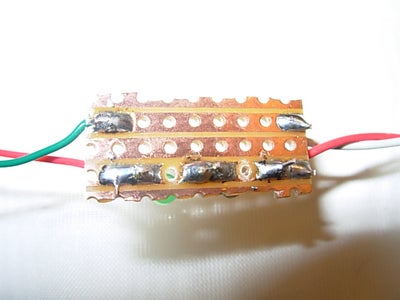

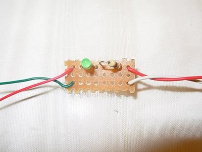

Start by breaking the copper as I have done in the picture. Then place and solder the positive wires with the battery clip and the crocodile/alligator clips on the strip with the broken tracks as I have done. Then start by placing the 390ohm resistor leaving a break in the copper between the two leads on the broken track (next to the battery clip) and solder it in. Then place the LED on the broken track (the positive way around and next to the crocodile clip) and solder it in leaving a break in the copper between the two leads.
Step 3: Connect It Up
All thats left to do now is connect it up to a 9v PP3 battery and connect the clips to a component or circuit you are going to test. If you are testing an LED both LEDs will light up brightly. *Note if you are testing a capacitor remember to connect it with the correct polarity or you risk your capacitors life.
