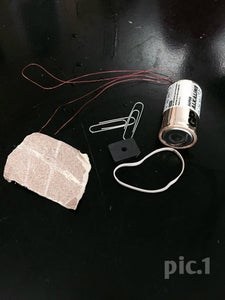

  • D battery
  • 2 paperclips
  • Copper wire
  • elastic
  • Sandpaper
  • Scissors

  1. Gather your supplies

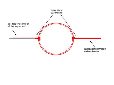

  5. On one wire end, sandpaper enamel off all the way around, but leave some un-sandpapered wire before coil
  6. On the other wire end, sandpaper enamel off on only one side of the wire. Half should still have enamel while the other doesn't. (see fig.1)

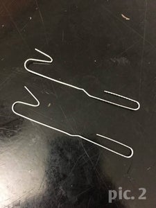

  7. Bend one end of paperclip, into a hook shape (See picture 2)

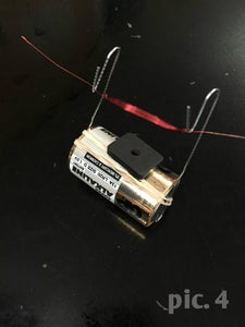

  8. Using an elastic, connect the paperclips to the positive and negative end of the battery (See picture 3)
  9. Place a small magnet, on top of your batter, making sure it's lined up with your paperclips
  10. Finally, balance the coil within the hooks made in the paperclip, right above the magnet, should start spinning (as seen in video) once built. (see picture c for steps 9 and 10)
