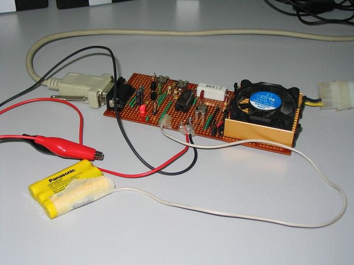

I have built this project to burn my small PIC's
This is a serial programmer works on the RS232 ( PC serial port ), known as JDM Programmer, thanks to the site http://pic16f84.hit.bg/ which contains the schematic and the programmer software.
The programmer is powered from the Serial port itself, so there's no need to any external power supply.
But be careful this circuit will not work with the Laptop Serial port due to the weak voltages it has.
- I have used a very nice programmer software called "Win PIC Programmer" you can download it from
http://freenet-homepage.de/dl4yhf/winpicpr.html, it's very stable and powerful.
The project has been tested with the following IC's :
PIC16f84A
PIC16f628A
