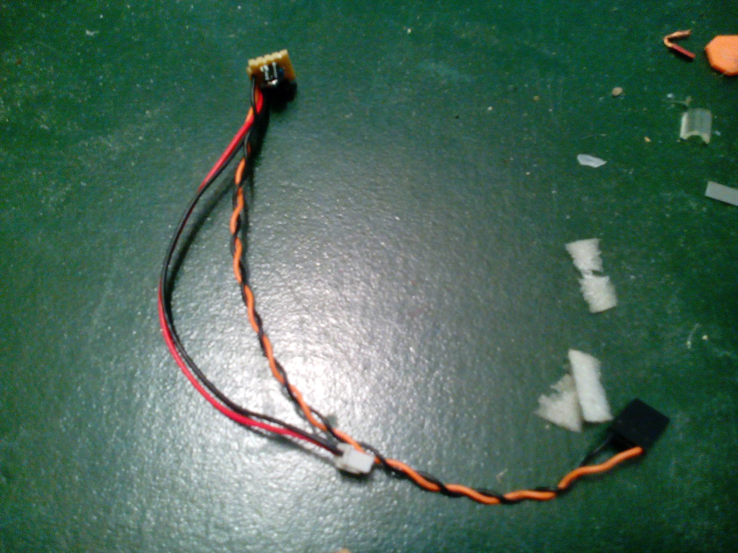

great circuit, I made mine as small as possible. orange and black wires are where the power comes in, I got up to 25v, and red and black are where the LEDs go. I have two 75 ohm resistors instead of the 39 ohm one, to handle the extra voltage. thanks for sharing this circuit.

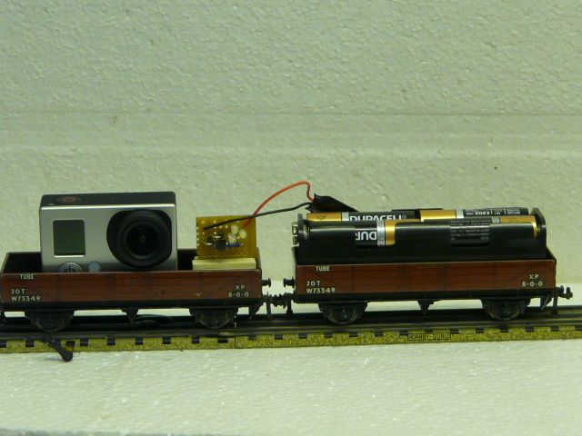

I finally got around to making my 'ible using your circuit. I'm currently experimenting with a driver circuit I made, I'll post an 'ible on that sometime in the next couple of months. But it is still based off yours.
