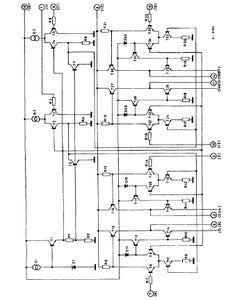

The controller needs to not only pulse the motor windings with the Arduino, but also needs to bring current in from a fairly robust auxiliary power supply. This is achieved by using a set of 4 integrated circuits containing power transistors, resistors and diodes, all in contained within the four neat little packages.

As I said earlier, we could power the motor directly from the Arduino PWM pins if it was small enough, but in the real world we need to use the low current signal from the Arduino to trigger transistors to allow a high current, high voltage synchronised signal from an auxiliary power supply. Ultimately, it just boils down to a simple transistor although there are diodes and resistors in the chips to facilitate this. Let's not go into too much detail!
