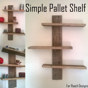

Introduction: Simple Modern Pallet Shelf
What inspired me?
I love using this type of material. Not just is it cheap and practical but the aesthetics are amazing! Anyway, I was looking on google at a few pallet ideas and lots if shelves came up, so I began to design a very simple shelf using only a few of lengths of the pallet.
This us a very easy project and if you complete this instructable, but still need a little bit of guidance, be sure to inbox me ot comment bellow.
