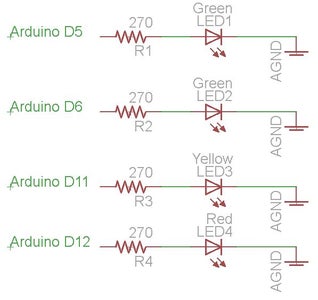

Solder long cables to the sensor Vcc, GND and AN holes.
Connect Vcc to Arduino 3.3V
Connect Gnd to Arduino GND
Connect AN from Sensor to Analog  0 input of Arduino
Solder the 4 LEDs in the order of Green/Green/Yellow/Red. Note the polarity and see diagram attached
Set a resistor in series of each LED positive leg.
Connect the LEDs to Arduino as following:
  Digital pin 5 of Arduino to left most Green LED
  Digital pin 6 of Arduino to 2nd Green LED
  Digital pin 11 of Arduino to Yellow LED
  Digital pin 12 of Arduino to Red LED
Connect the FTDI (note the polarity) to the Arduino board and connect the FTDI to your USB.

    There is schematic for the LEDs connection inside.
    The piece that is not drawn in schematic is the sensor side, however here is the description to connecting it, should be fairly simple to handle without schematic I think:
