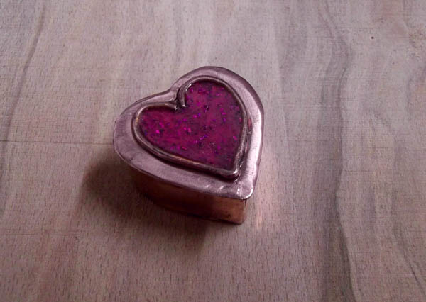

1 Person Made This Project!
- crazyg made it!
