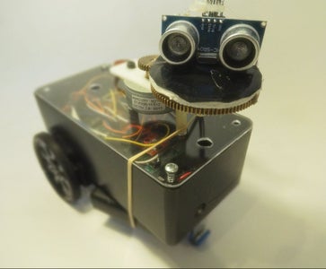

Introduction: Simple Robot Base
Creating robots can be very interesting, but trying to build a rigid base for a robot can be tough. In this instructable I will show you how to build a rigid robot chassis.

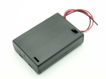

First, start with the enclosure. You will need to drill holes for the two servos and the battery pack. After this is completed you can either glue, bolt, or use double sided tape to secure the servos and battery pack to the enclosure. You will need to add a nub to the back of the robot to keep its butt from dragging on the ground.
Step 3: Wire Up the Electronics

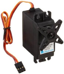

The red wire of the battery holder goes to the arduino pin vin and the black wire goes to ground. The continuous rotation servos have three wires.
Brown - Gnd
Red - 5v
Orange - D9 (right servo) and D10 (left servo)

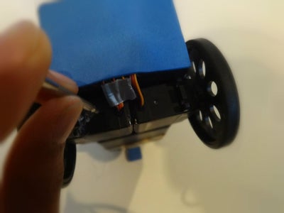

Step 4: Calibration of the Servos
To start you will need to upload a calibration file to the arduino that is down below. As the program is running use a screwdriver to turn the trim potentiometer of both servos. turn the screwdriver until both servos stop moving. You have just calibrated the servos!

You can attach anything to this robot base. For example, you could put an ultrasonic sensor on the front and create an autonomous robot.
