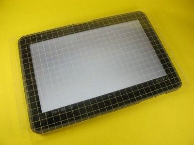

This light table using tablet as light source, it is much better that using LED or High Power LED.
Since I have an old samsung tablet 10.1, I install two "free apps" from android market.
Tiny Flashlight
https://play.google.com/store/apps/details?id=com....
TF: light table (plugin for the Tiny flashlight)
Procedures

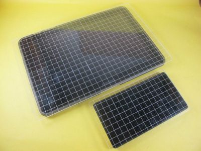

1. Cut the acrylic slightly larger than the tablet (Plastic & Acrylic Scorer Cutter).
2. Measure and cut lines on acrylic with 1cm spacing to make grids.
3. Sand the corner of the acrylic.
4. Install the apps to tablet.
5. place the tablet into the cover, since the cover it made of silicon, it acts cushion effect and hot the acrylic sheet on the top of the tablet.

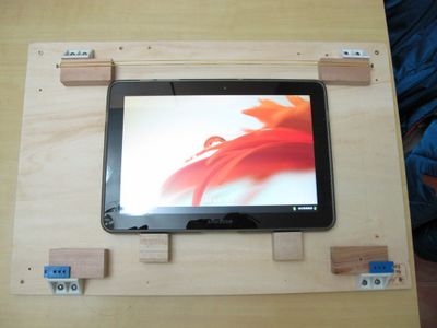

Step 2: Fail Design...
Maybe it is not the fail design, anyway, just for interest.
