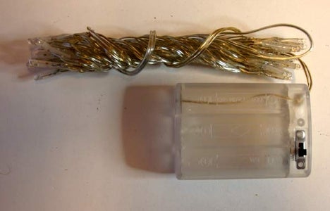

Buy a cheap (less than 2 euro's) LED Christmas thing, just having 20 LED's, connected to a nice battery casing.
(The advantage is that you don't have to solder the LED's.)
We will use a transistor BC547 (15 cents) and a resistor, 5K 10 cents.
The LED's will be on using the switch on the casing.

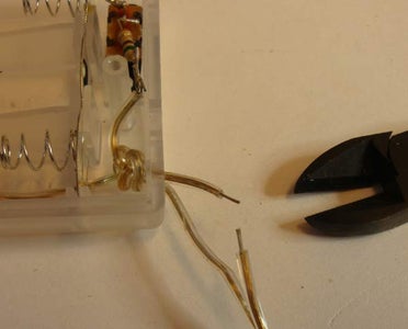

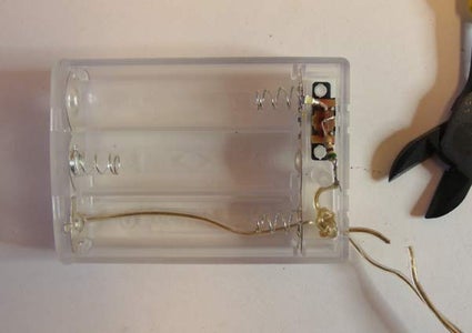

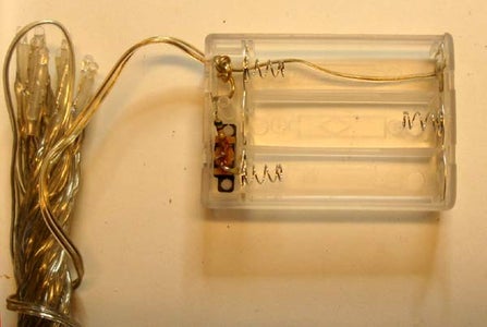

Step 1: Cutting
Step 1.
Cut one of the two wires going to the LED's.
Because of the knot we cannot be sure which wire we have cut.

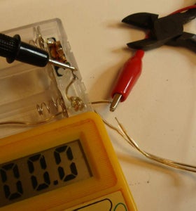

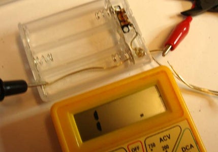

Step 2: Measuring
Step 2:
Measure using a simple Multimeter if the wire is coming from the GND or the 5V.
This decided the direction for the transistor.
Looking at the image you can see which side of the transistor to connect to the wire.

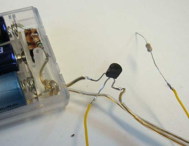

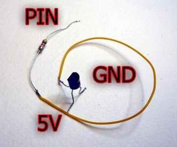

Step 3: Soldering
Step 3:
Solder the resistor to the base, the middle leg of the transistor and connect this to PIN 13 of the Arduino
Then with the standard Arduino BLINK script you can test the working.
