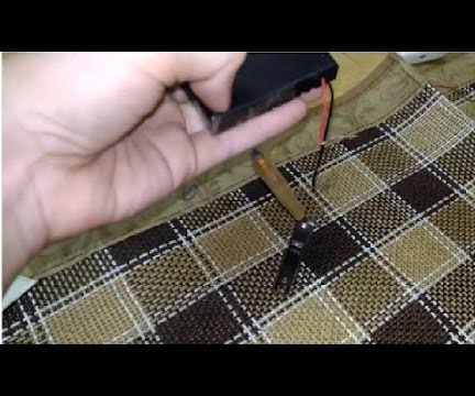

Take a little plastic bowl and fill with salt solution
Step 2: Take Two Big Screw
Using two big screw as electrode. One as Anode and one as Cathode
Step 3: Prepair the Power Supply
The electric flows must be Direct Current (DC) remember, must be DC, AC current won't work. I use two 24v DC Adapter from computer charger connected in serial to gain the voltage to 48v with the current flow about 6 amps.
