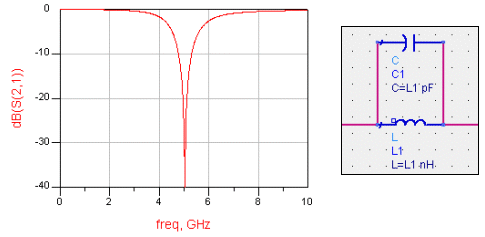

(The picture is from http://www.rfdh.com/bas_rf/begin/reso.htm)
The principle of application is finding the resonance point of LC circuit.
Parallel LC circuit's frequency graph is decreasing then increasing shape and there is one peak. The peak is the resonance point. If we find the peak, then we can calculate inductance or capacity by using given capacitor or inductor.
