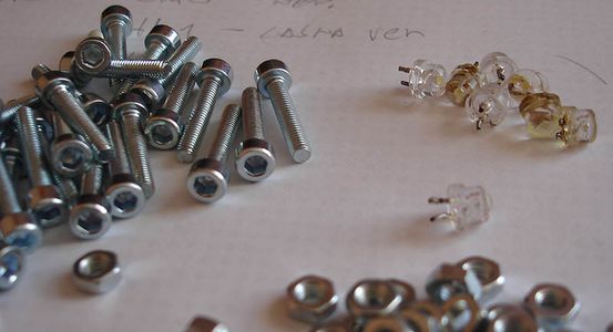

Step 1: What We Need
8 colorful pieces of plexi-glass ( or you can use same color, they just need to be discrete, I used 10 x 7 x 0.5 cm )
2 large pieces of transparent plexi-glass ( I used 56 x 12 x 0.3 cm )
8 leds ( I ripped them off from one $3 led torch, basically use wide angle! (with 15 or 45 degree LEDs it is looking bad, use as wide as possible ), high power, white LEDs )
bolts and nuts
black spray
wires
parallel port connector ( I used one from old printer )
hack-saw
sandpapers ( 200 & 400 )

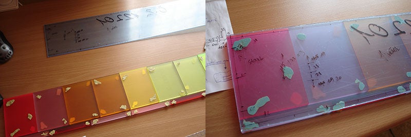

Step 3: Drilling & Sanding
Let's put it together, I used chewing-gum like material to fix it in place.
And drilled about 40 holes. It is better with some vertical-fixed drill for better quality. And take it slow
with plexi-glass, or train few holes on dummy piece.
Even if you did carefully drilled all holes like me, there may be not-matching edges (foto3) after putting together. It will look better if you shape them to one line. First use 180 grid sand paper if you end with big gaps like me. Then use 250 grid. Finally you can play hour or so with number 400. Until it's looking perfect.

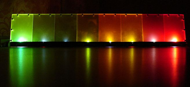

Step 6: Action!
In real world is even better looking because eyes are slower than digital camera, so it is glowing nicely.
