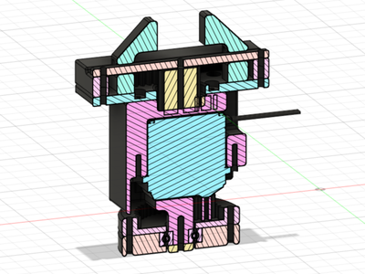

Step 1: 3D Print the Parts
Start by printing all 11 parts:
  1. Bearing Cap
  2. Clamp Key
  3. Wrist Mount
  4. Rack and Clamps
  5. Clamp Housing
  6. Motor Housing
  7. Clamp Housing Bottom
  8. Wrist Outside Gear
  9. Clamp Drive Gear
  10. Wrist Drive Gear
  11. Clamp Motor Gear

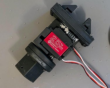

Step 2: Assemble Base
My 3D printer isn’t perfectly calibrated, so I had to drill out the holes slightly. This step may not be necessary if your printer is well-tuned.
  1. Attach the servo motors to the Motor Housing using #6 x 3/8" Phillips Pan Head Self-Tapping Screws.
  2. Super glue a 3mm x 25mm stainless rod into the designated hole in the Motor Housing.
  3. Slide the Clamp Drive Gear onto the stainless rod.
  4. Attach the Clamp Motor Gear to the servo using an M3 x 6mm bolt.
  5. Secure the Clamp Housing Bottom to the Motor Housing using six #6 x 3/8" Phillips Pan Head Self-Tapping Screws.
If you are using your own code, be sure to test the servo before adding the clamps to avoid damaging the gripper by over-rotating. If you use the code I provide, this has already been accounted for.
Step 3: Assemble Clamp
  1. Place the left and right clamps into the Clamp Housing.
  2. Flip the clamps and Clamp Housing, then insert them onto the Clamp Drive Gear. (Ensure the clamps are as open as possible. This step may require some finesse to properly align the gears.)
  3. Slide the Clamp Key through the clamps and secure it to the Clamp Housing using two #6 x 3/8" Phillips Pan Head Self-Tapping Screws.
  4. Attach the Clamp Housing Bottom to the Clamp Housing using six #6 x 3/8" Phillips Pan Head Self-Tapping Screws.
  5. Apply white lithium grease or another suitable lubricant to the gears and any parts that may rub together.
Step 4: Assemble Wrist
  1. Insert the bearing into the Wrist Mount.
  2. Attach the Wrist Mount to the Wrist Outside Gear using four M3 x 16mm machine bolts.
  3. Attach the Motor Housing to the Wrist Mount using one M3 x 8mm machine bolt.
