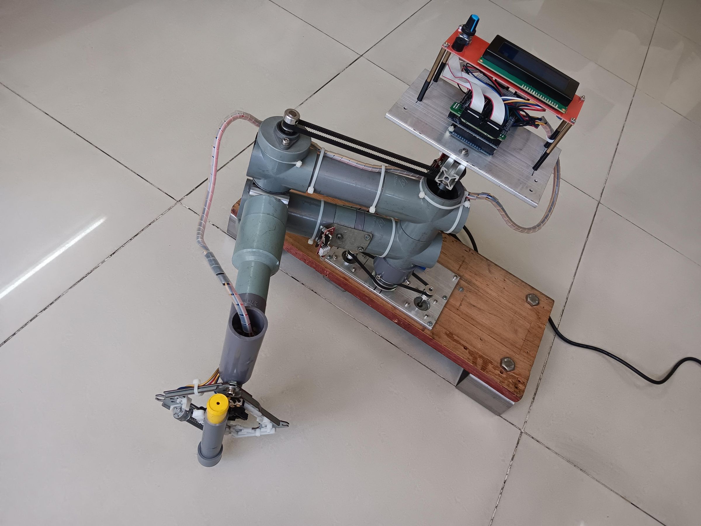

Step 1: Stepper Motors Preparation
I prepared 2pcs x NEMA 17 stepper motors with long and short shaft and temporarily fixed 2pcs x GT2 timing pulley 20 teeth on them.
2pcs x GT2 closed timing belts 200mm and GT2 60 teeth timing pulleys were also prepared for drilling on the mounting support in the next step.
Step 2: Mounting Frame
Drill holes in the aluminum plate to mount the stepper motors and pulleys.
I assembled 2020 aluminum profiles 200mm and 100mm long into an L shape and connected them to the aluminum plate. One shaft 8mm and bearing was used to mount the Scara's shoulder parts.

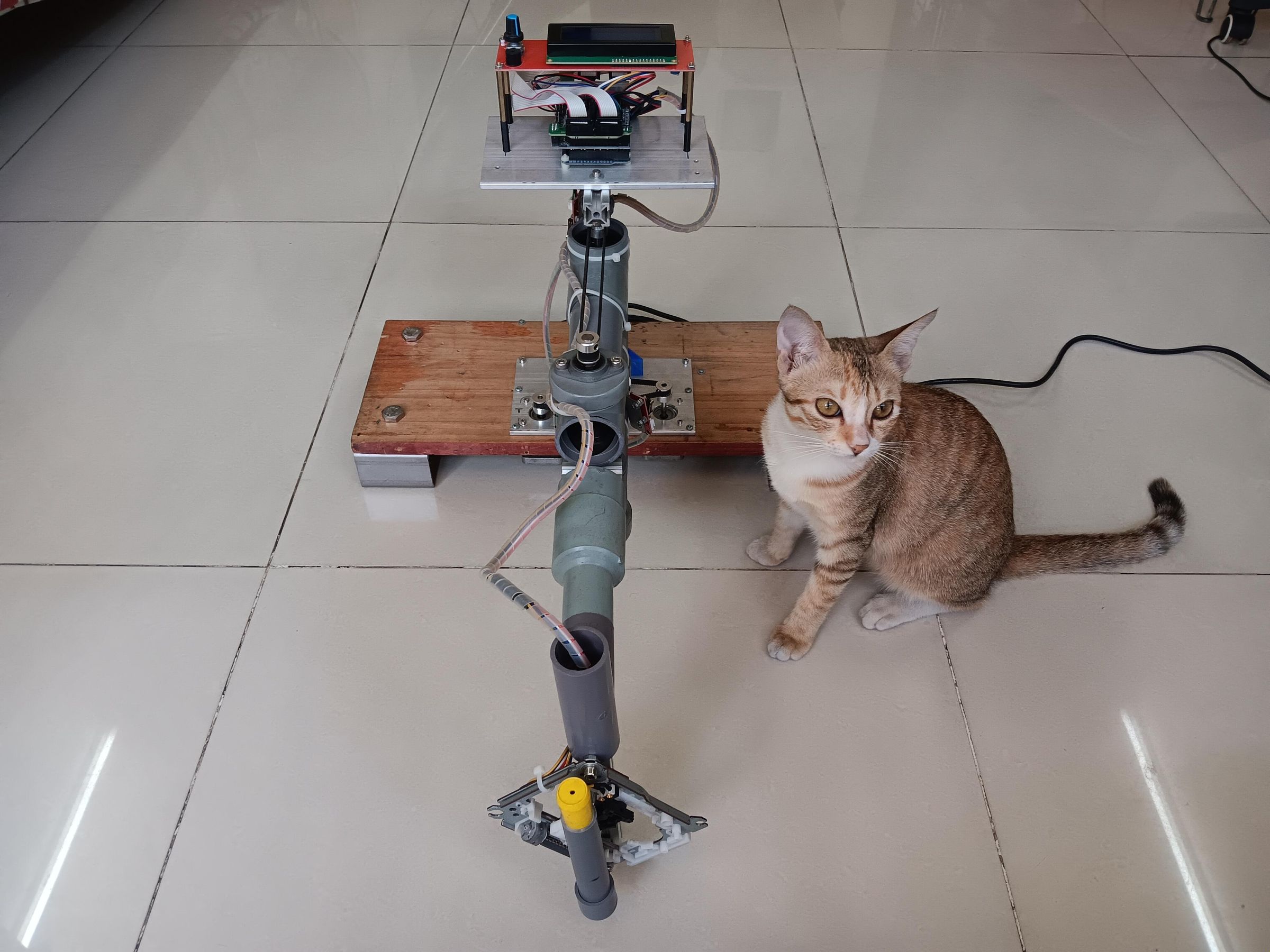

Step 3: Shoulder Assembly
I used PVC fittings to assemble Scara shoulder parts.
Stepper mottors, pulleys, timing belts, shoulder PVC fittings were arranged as below. The bottom 60-tooth pulley was tightened onto the shaft to drive the top 20-tooth small pulley, it will link to the SCARA's elbow. And the 60-tooth pulley that attached to the PVC fitting (upper 60 tooth pulley) was not tightened to the shaft, it drives directly to the SCARA's shoulder.
Step 4: Elbow Assembly
The SCARA elbow was also made of PVC fitting and was driven via a 400mm closed timing belt from top pulley shoulder.
Elbow joint was coupled to the end-effector by a round bar clamping support plus small aluminium profile 2020 and PVC reducer 42mm to 27mm.
The elbow shaft was fixed by 2 locked bearings at the top and bottom.
Step 5: Reinforced Frame and Base
I used one wodden plate and 4pcs x steel channels to reinforce the foot base.
The vertical aluminum profile was also stiffened by some corner brackets.
Step 6: RAMPS 1.6 and LCD
I have installed an Arduino Mega 2560 and RAMPS 1.6 on the aluminum plate and they were all placed the robot arm's top.
An LCD was also mounted on the aluminium plate.
Step 7: Endstops
I prepared 2 small supports for X (shouder) and Y (elbow) endstops.
Mounting X endstop on the vertical aluminium profile.
And Y endstop was fixed on the PVC fitting - linkage arm 1.
Step 8: Connection and Power Supply
I connected all wires of X and Y axes to RAMPS 1.6.
One power supply 12VDC was installed underneath wooden plate.
Step 9: Z Axis
I used an DVD/CD ROM stepper motor and its frame to build Z axis. Since the aluminum profile 2020 fitted perfectly inside an 27mm diameter PVC pipe so I could easily do this Z axis assembly.
One micro switch was mounted on the CD/DVD frame as Z max endstop.
Step 10: Cable Protection
I used one small cable tray dimension 20x20 to cover all wires going from bottom to top.
I fixed all wires running along the robot arm with cable ties.
In the end, it didn't look very pretty, but my SCARA plotter was equipped with enough functions to operate for studying and testing.
