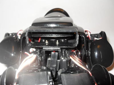

The Humanoid is held onto the chair using an upright metal post that he lowers himself onto, there is a similarly shaped hole attached to his rear (oh er) which ensures it secures him well. There are also two rubber posts for him to rest his feet on to stop them dragging on the ground (made from two plumbing washers).

The humanoid was completed and I decided on the colour scheme. Painting was easy enough with special RC polycarbonate paints but I had some leakage around the edges of the masking tape I used which needed to be touched up. Two gyros were set up to keep him stable and a flashing multicoloured led was added to his chest to shine through the shell.
His head needed complete modification as I needed to mount a wireless camera inside and a power converter to provide it with the correct voltage. Unfortunately, during testing it became apparent that movement of the servos was causing interference in the video signal. I ended up mounting a PP3 battery in the head which meant an on-off switch and holder was required. I also had to make a wedge shaped shim to angle the head upwards towards the guests. Two ultra bright blue LED's were added for his eyes. The head shell was modified to ensure I could quickly access the battery by removing a couple of clips.
This all added weight to the head and meant that none of the standard moves would work. I had
one night to completely re-code the bare essential moves that I would require on the next day.
