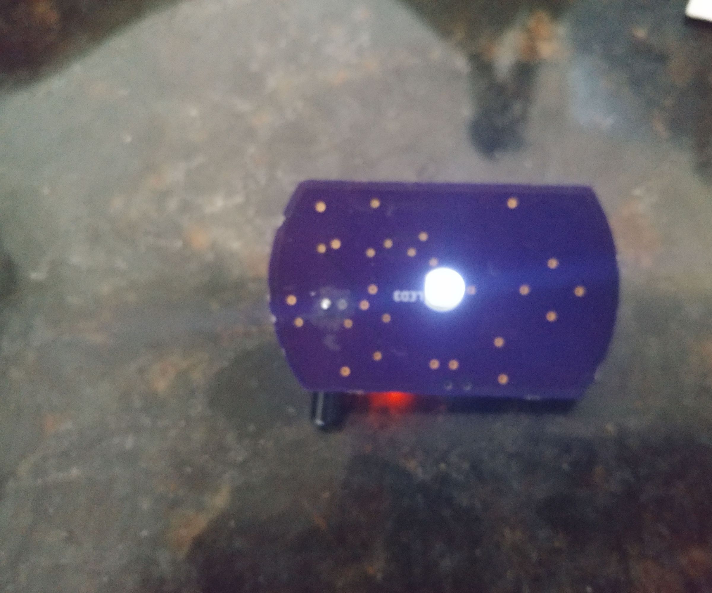

Step 6: Mounting the LEDs on the Front of the Truck
This project is all about the lights!
Remember those lanterns you took apart? Time to use them.
In the video we show how we attached the LED boards from the lanterns.
Notable parts of the video:
- Aluminum plates were cut and placed behind the LEDs to act as a sort of heatsink.
- Use the LED boards themselves as a template for placing holes in the aluminum plates
- To mount the plates and LED boards to the riser we used two methods; #8-32tpi self threading screws. And we drilled (#26 drill bit for the pilot hole) and tapped one of the risers for #8-32tpi cap-head bolts. Either way works. Since you are threading into plastic, threads could easily get stripped or worn out easily. So, self-threading or mounting screws would probably be the best idea.
- On the front truck, we put in two rows of lights from two lanterns. See above pictures for double light mounting.

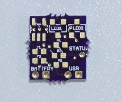

Step 8: LiPo Charger Assembly
Solder a pair of 18 gauge wires to the GND and BAT vias on the LiPo PCB. Also, put a drop of solder across the two pads on the board (note the red arrow) to change the charge rate from 100mA to 500mA.
Step 9: Heat-shrink the LiPo Charger
Apply a piece of ¾” heat shrink to the LiPio PCB. Don’t cover up the JST connector.
