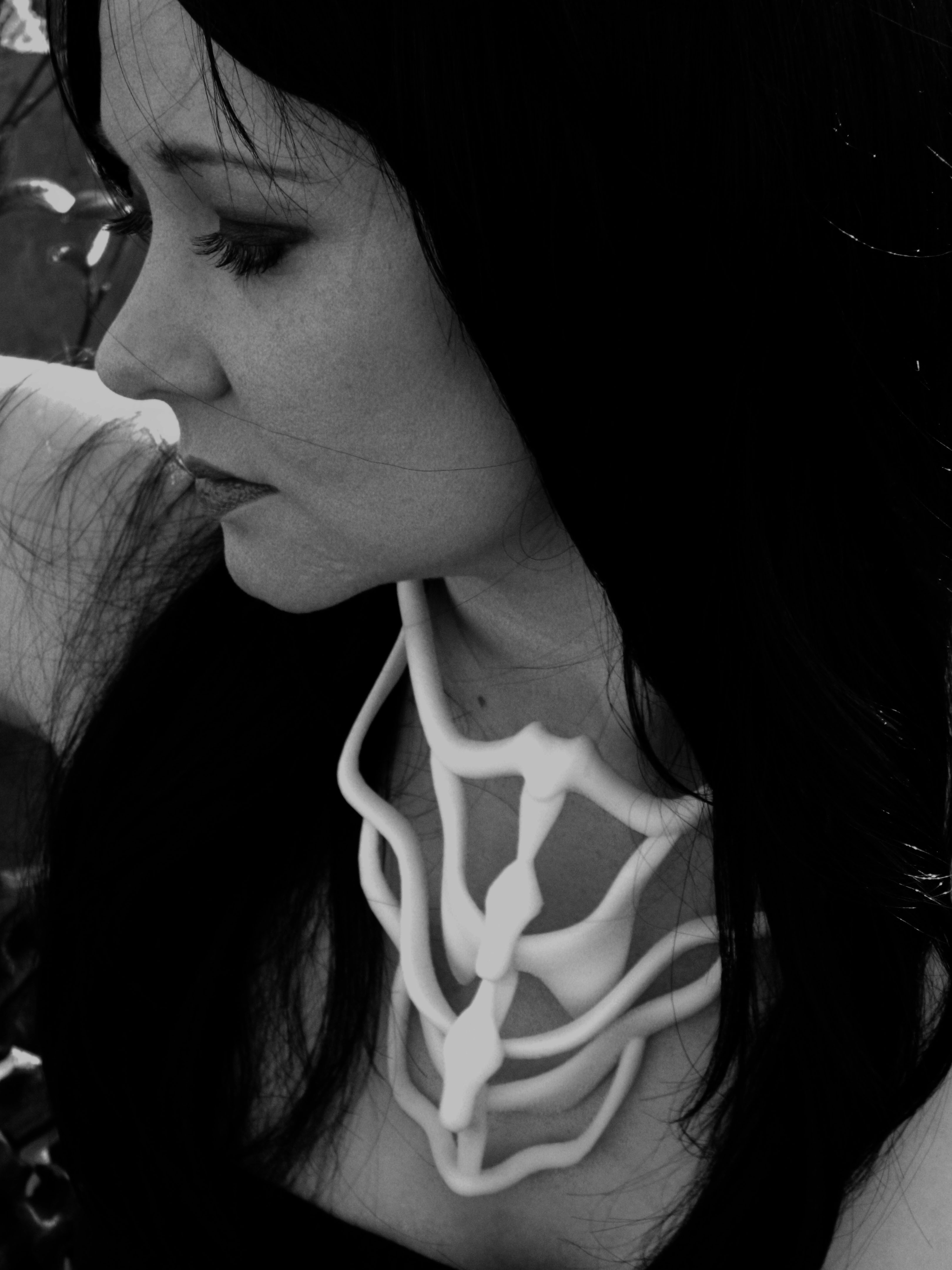

Once the model is finished printing, the black support material needs to be removed. This can be done by machine most efficiently, but I do not have access to one. Instead, I mixed a solution of Lye into regular tap water.
I used 1 table spoon of lye to 1 gallon of hot water. You can break off some large chunks of support material prior to going in the lye solution.
IMAGE 91 Shows the complete physical object, prior to lye bath with all the support material still intact.
After 11 hours in the lye solution, I was able to remove a majority of the structure from the model. I changed the water, added the lye again, and after another 9 hours or so, the piece was completely free of support material.
IMAGES 92, 93 Show the progression through the lye
Step 8: Completed Necklace
Here are the results, a wickedly cool finished piece. Design meets Fashion!
