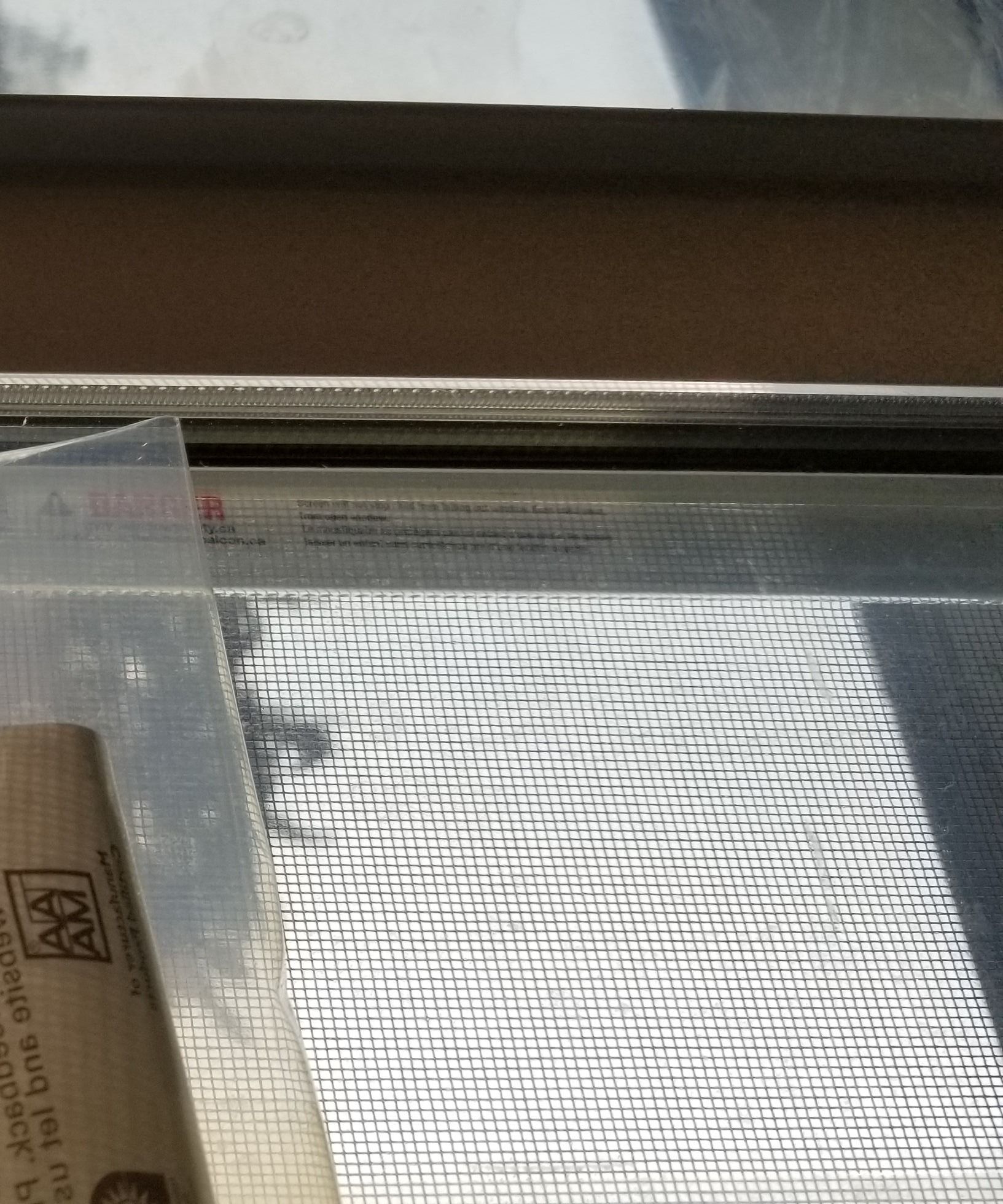

My lites were 770 mm long and 606 wide including the lip surrounding the lite. this "ledge" lets the doweling rest on the inside edge of the lite while supporting the cloth part of the blind.
