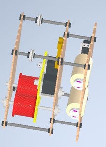

In this first subsection, the mechanical designs are discussed. Most of the parts of the robot were laser-cut and 3D-printed from self-made models.
1- Requirements
Regarding the movement part, a minimal amount of torque will be needed at the place where the drum is located. This torque depends on the mass the robot will have and on the radius of the drum that will be used to roll up the cable. The minimal torque needed will also depend on the angle under which the robot hangs on the building.
Concerning the cleaning part, the determination of the minimal torque is more difficult. The torque will depend on the frictional force between the rollers and the window. This force depends on the frictional constant (static at first then dynamic when the roller gets moving) and the normal force with which the robot pushes against the window. This force will depend on the mass of the robot and the angle between the robot and the building, which will be largest near the top of the building. The results of these calculations can be found in the following section.
2- Design process & Considerations of material and manufacturing choices
In order to make sure the stepper will provide enough torque for the movement part of the robot, a gear reduction is added. To calculate the minimal needed torque, a mass of 2.5 kg is assumed for the robot as well as a drum radius of 3 cm and an angle of 30° between the robot and the building. This provides a torque of 0.21 Nm. The classical stepper motor NEMA-17 should be able to provide this. However, the system will also have quite a lot of internal friction. To somewhat increase the margin, a gear ratio of 1.1 is added. The axles on which the gears and drums turn will be made of steel bars. The gears will be fabricated out of plexiglass to make sure that the teeth of the gears don’t break under considerable stress. The gears can be easily laser-cut out of a sheet of plexiglass. The drums are quite thick, and this allows them to be 3D-printed out of PLA since this material should be able to withstand the stresses when the part is this thick. To further limit the friction, ball bearings are also introduced in the drum design.
For the cleaning part, a torque value of 0.042 Nm is calculated. This is however a rough estimate since the actual friction coefficient is difficult to determine. To provide ample torque, servo motors will be used that have been modified to make full revolutions. These servo motors will be directly connected to an axis on which the cleaning rollers have been attached. The axis will again consist of a steel part and the connections between the servo motor and the axis will be 3D-printed. Ball bearings are again used to reduce the friction of the axis with the 3D-printed components.
To produce the cleaning rollers, paintbrushes are used. A towel is then turned and glued around this roller twice to make it thicker. This way only the towel will touch the window when the robot is moving upwards and no damage to the window will be done.
Finally, cable guides will be introduced in the design. These guides will make sure the cable always leaves the robot in the same place and will stabilize the design.
3- CAD design
Images of the initial CAD design can be seen in the images above. The side plates are not added so the insides are clearly visible.

Step 6: Integration Guide
The two subsystems are put together by using threaded bars that interconnect the MDF plates on which the different subsystems are mounted. The Arduino board can then be mounted and the CNC shield placed on top of this. After doing this, the electrical connections to the different systems can be put in place on the CNC board. The H-bridge can also be installed and the breadboard with the voltage reduction can be put in place. When the necessary connections are made, the electronics can be enclosed in a box and the side plates can be placed to close the robot. Finally, when the code is uploaded to the Arduino and the connections to the power supply are made, the robot is ready to be started.
