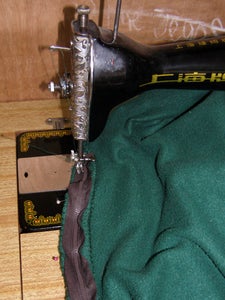

Step 3: Add Zipper and Hoodie
- Sew top edge of hoodie. This step is not clearly depicted below in the photos, but it is simple; just fold the hood piece in half and sew along the longer edge that is sandwiched together.
- Line up and pin the zipper on the body part of the bag starting from where you want the hoodie opening to be (from center toward the outer edge.) ***Your zipper must open from the neck then down the side, otherwise it will be difficult to get into!
- Sew the zipper from about the center of the top end of the front side of the body round the corner and down the side. (see photo below for result)
- Now you can pin and sew the zipper to the other side of the opening of the main body piece (not the top though, that is where the hoodie goes!)
- After attaching the zipper to the body you can pin and sew the bottom of the hood all the way around the top of the body. Make sure to line up the zipper in the center with the part of the hood that will become a flap. Be extra careful sewing where the zipper stops and the back of the sleeping bag is sewn directly to the hoodie.
