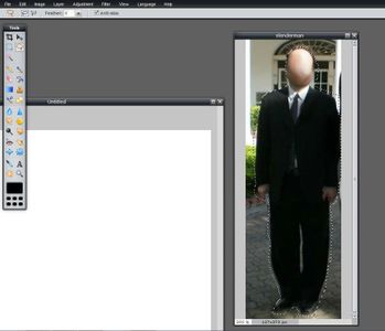

Step 1: How I Turned My Brother Into Slender Man
I was looking through my photo library for a image of someone in a suit.  I came across my brothers wedding photo which was perfect (I hope he doesn't mind).
  • To start editing the photo I went to the Pixlr website and select Open Pixlr editor (advanced). Then clicked on Open Image from computer
  • I cropped the image so that it had only my brother and smudged his face with the smudge tool.
  • Using the lasso tool I copied and pasted him onto a new blank background.
  • With the eraser too I cleaned up image so that it is just him.
  • I resized the image with out the proportion constraints to make him taller and skinnier.
  • I then created a new layer and used one of the flower brushes adjusted to a large size to create Slender Man's snake like protrusions.
  • I used the Free transform tool from the edit menu to rotate them and copy and paste a set for the other side of his body.

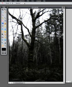

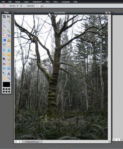

I started by making some adjustments to the original photo.  I reduced the vibrancy of the image to remove most of the colour
  • Go to the Adjustment  menu and select Colour vibrance.
  • This gives you a box with a slider, I moved the slider almost all the way to the left

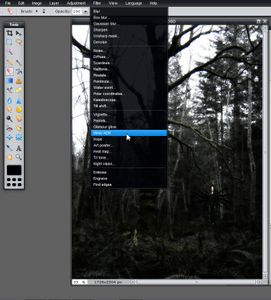

Then I used Pixlr's Glamour Glow filter to make it more intense.
  • To use glamour glow go to the filter menu and select Glamour glow

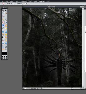

To bring Slender Man into the image. I went to the image of Slender Man, select him, copied and pasted him into the forest scene.  I selected Free transform from the Edit menu to move, resize and rotate the pasted man.
Step 3: Filter Effects
In Pixlr, when you paste an object into an image it is on a new layer.  This is nice so that you can make adjustments or use filters on that object alone as well as adjust the opacity.  In this case, on the layer with Slender Man I used the Mimic HDR filter from the filter menu.  This created a halo effect around him (otherwise I was afraid that he would be lost in the background).  I also erase the parts of his his snake like protrusions where they overlapped the tree in front (so that it looks like he is farther away than those trees).
