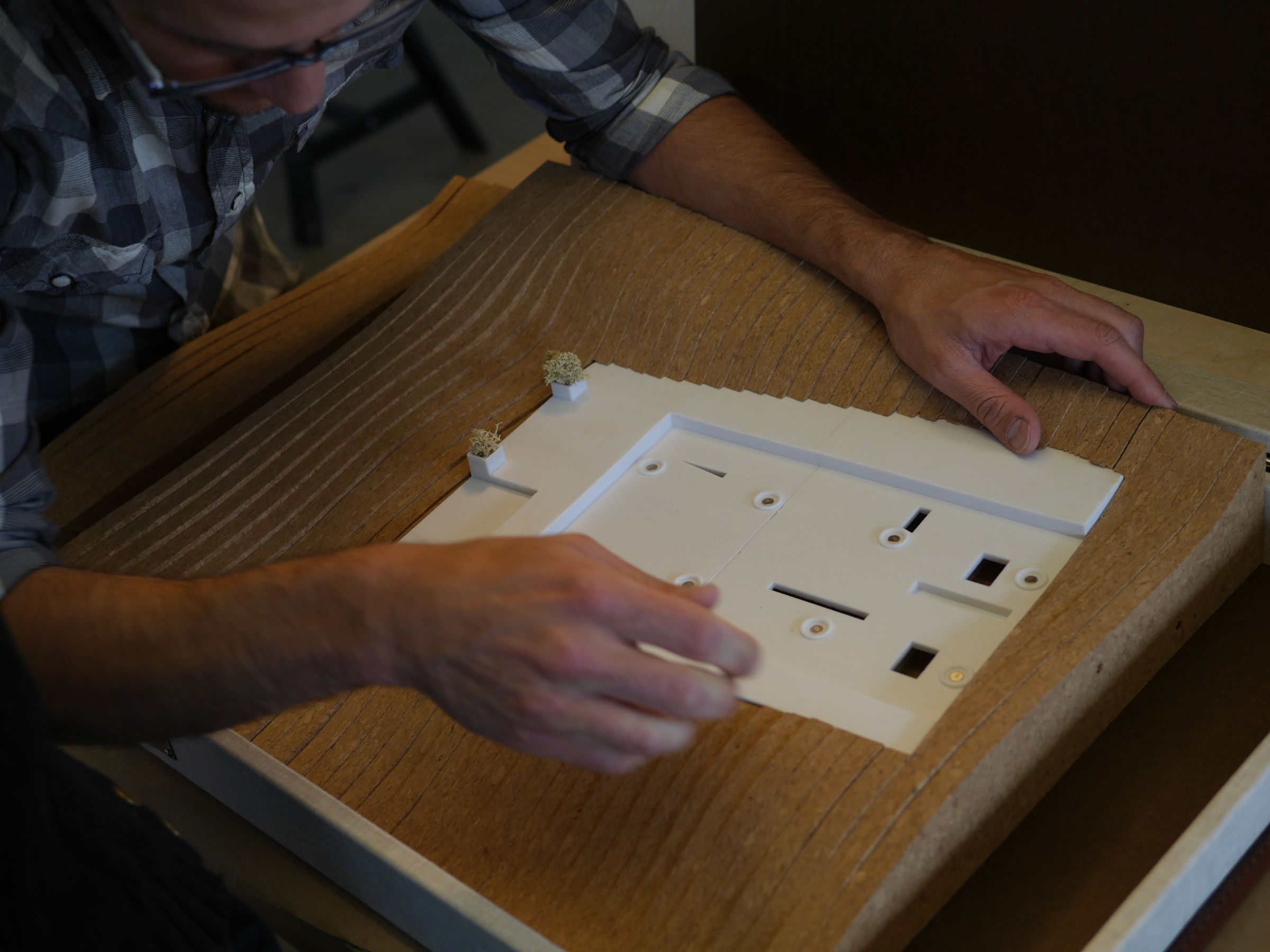

In the past I have directly milled blocks of plaster to produce slipcast molds, which is an incredibly messy and laborious process that leaves you with only one mold. This is unfortunate given that plaster molds can only produce 50-75 casts before they start losing a lot of definition. By creating a counterpositive you can easily produce many copies of your mold. For the larger version of this lamp I will mill a block of nylon on a 5-axis CNC router, but for the smaller version I 3D-printed counterpositives for each of the two mold halves.
Step 4: Mold Formwork
To house the counterpositives during the plaster casting process I used the lasercutter to make a tabbed box that I could easily disassemble and reassemble for future casts. Tape or rubber bands are sufficient to support the weight of a small cast like this one.
