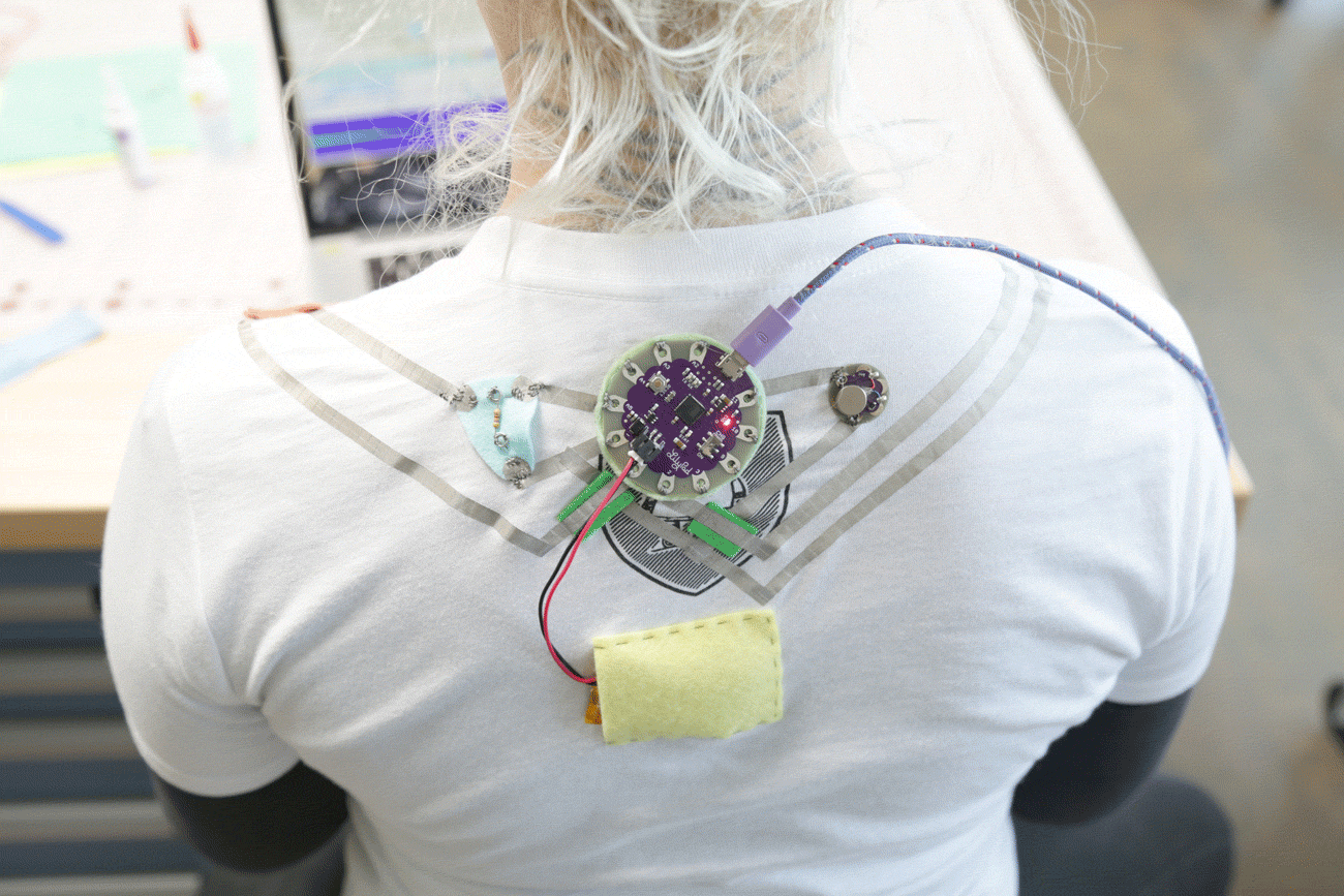

Turn the LilyPad USB off. With the board still plugged into the computer put the t-shirt on. If this proves to be too difficult, unplug the cord from the computer, put the shirt on then replug the USB cord. Turn the LilyPad board back on.
Open the serial monitor while the slouchAlert sketch is open and observe the sensor's values. Slouch and straighten like you did in the Read Body Movement lesson to see if the current threshold works for you. The threshold right now is 400. You can see below where it states that in the code.
As a refresher let's go over where this is found in the sketch again. Below is the part of the code that says - if the sensor value is more than 400 turn the vibe on and print "slouch" in the serial monitor. Otherwise, turn the vibe board off.
If it's already above 400 and detecting a slouch while you are straight you need to raise the threshold. If it's difficult to detect to a slouch lower this number.

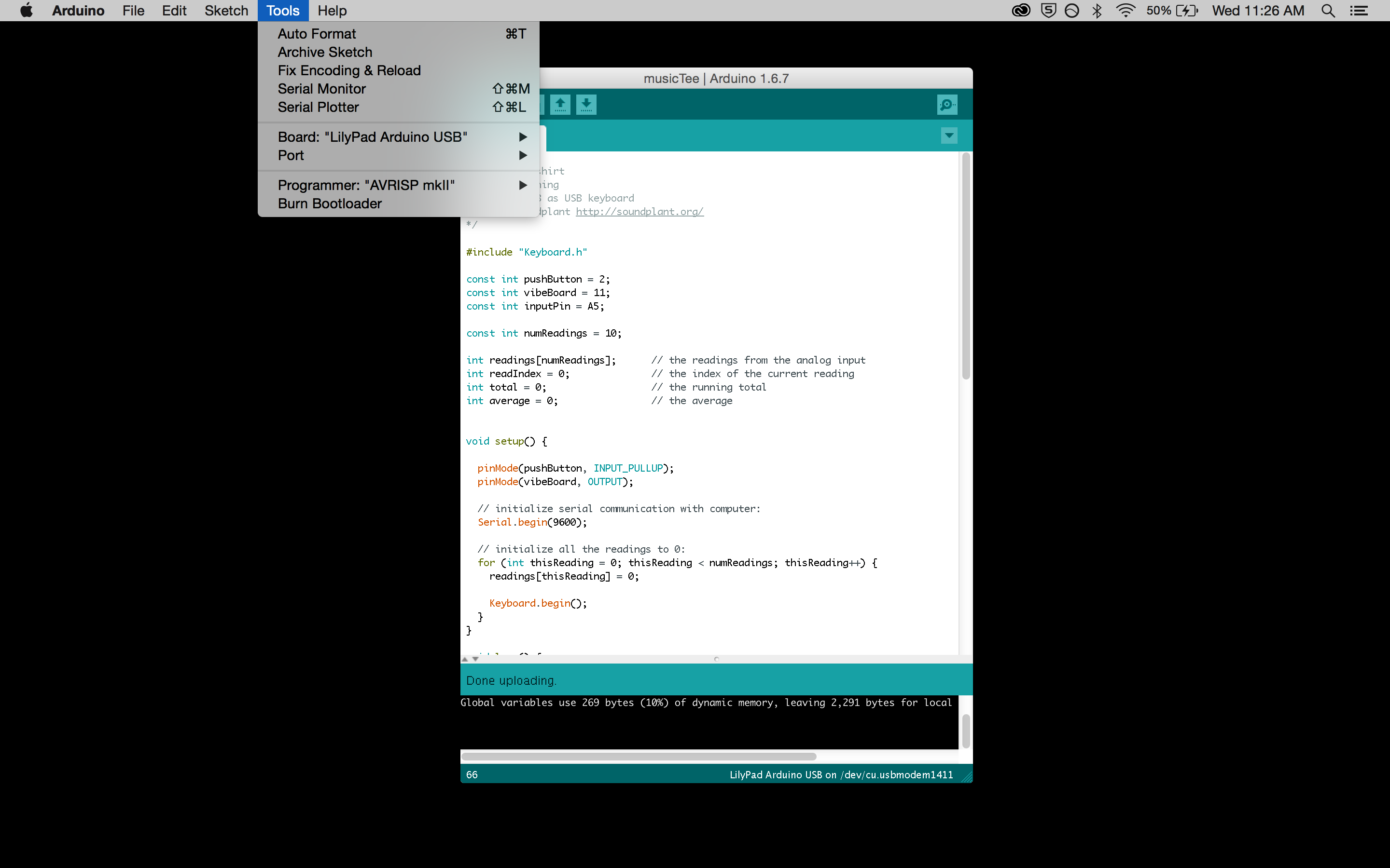

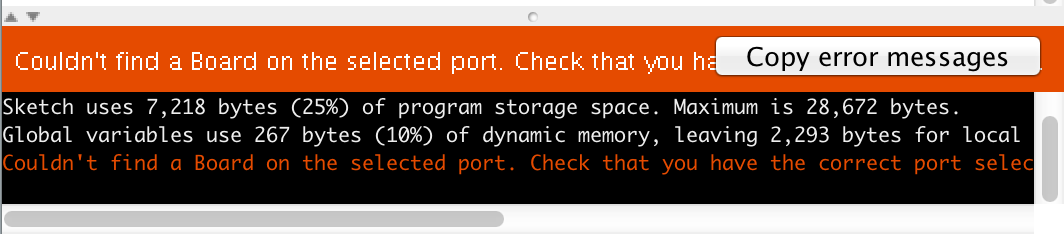

Plug the USB cord into the board and open up the musicTee sketch in Arduino. Check the board and port, then upload the sketch. Now open the serial monitor to see your sensor values. You will get the below error but you already selected your port. So, why does this pop-up?
It is because the LilyPad's port has changed to an HID (human interaction device) type port and will need to be selected again under Tools > Port. This means that your board has begun to emulate a keyboard because a keyboard is an HID. You will need to select this port every time you upload a sketch using the keyboard feature.
Now open the serial port and remember to close your snap switch in order to see the sensor values. Press or bend the sensor to see the character "n" print in the text field at the top of the serial monitor and "play" print in the window. Woohoo! You are ready to trigger some sound - well, almost. First, let's quickly go over the new parts of this sketch that makes this all possible. Keep the t-shirt plugged into the computer but turn the LilyPad board off.

To import a library into a sketch go to Sketch > Include Library > choose a library to import. It will add a line at the top of your sketch that starts with
#include
The musicTee already has this line at the very top which imports the Keyboard library.
#include "Keyboard.h"
Start emulating a keyboard by calling Keyboard.begin() in setup().
If the sensor value held in the variable "average" goes over 250 print "play" in the serial window and print the character "n" by emulating a keyboard press using Keyboard.press(). Emulate pressing the key for 100 milliseconds using delay() and then release the key with Keyboard.releaseAll().

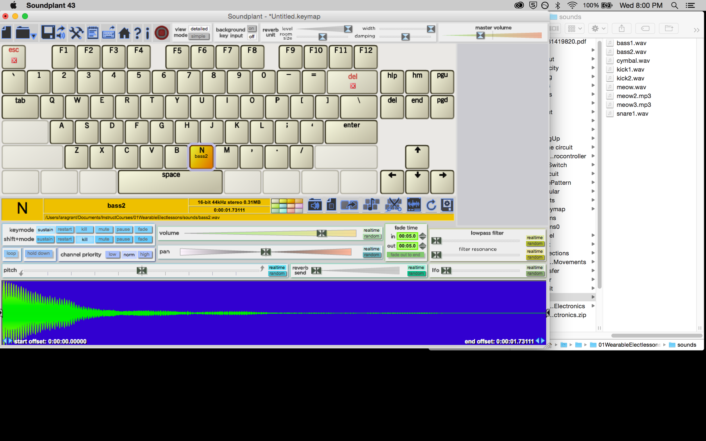

Step 7: Download Soundplant and Load Files
To trigger sounds with your LilyPad keyboard you are going to use a free piece of software called Soundplant created by Marcel Blum. Head over to the website to download and install Soundplant based on your operating system (sorry Linux!).
Open up Soundplant from your Applications folder and a virtual keyboard will pop up on your screen. This software is really fun and super easy to use. I love it because you can quickly change sounds whenever you like. Open the folder that contains the sound files you downloaded earlier in this lesson. Choose one and drag and drop it onto the "n" key. Check to see if your LilyPad is still off (it should be). Press the "n" on your computer's keyboard and the sound file will play.
Try dragging and dropping other sound files. Soundplant's website has a great list of where to get more free sounds on the download page.
Step 8: Trigger Sound With LilyPad USB
At this point, you have gotten "n" to print and you've gotten sound files playing with Soundplant. Now let's put these two things together. Turn on your LilyPad USB and the musicTee sketch that you have already uploaded to the board will start running. While in Soundplant, bend the flex sensor and the sound file on the character "n" will play. You have just created a gestural musical controller!
Hooray!

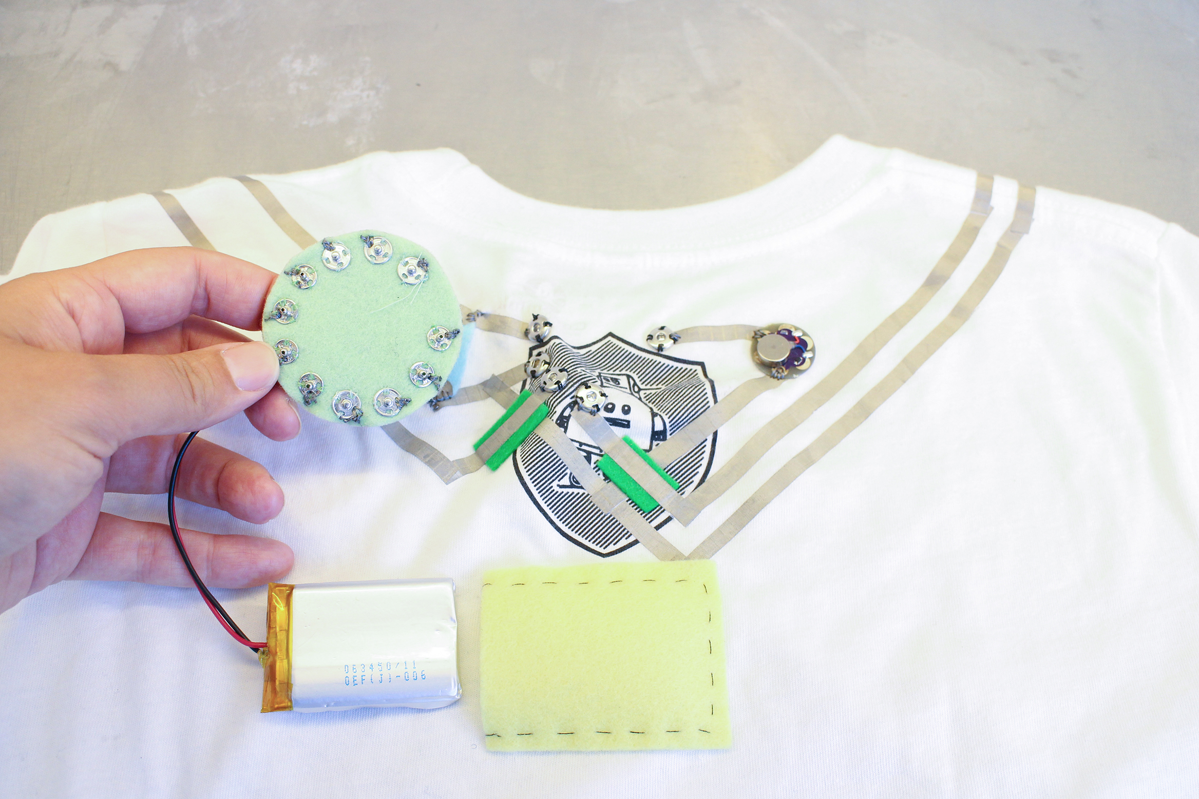

The first thing to know about washing a wearable: take out the battery! The other things you need to consider before throwing your threads into water are:

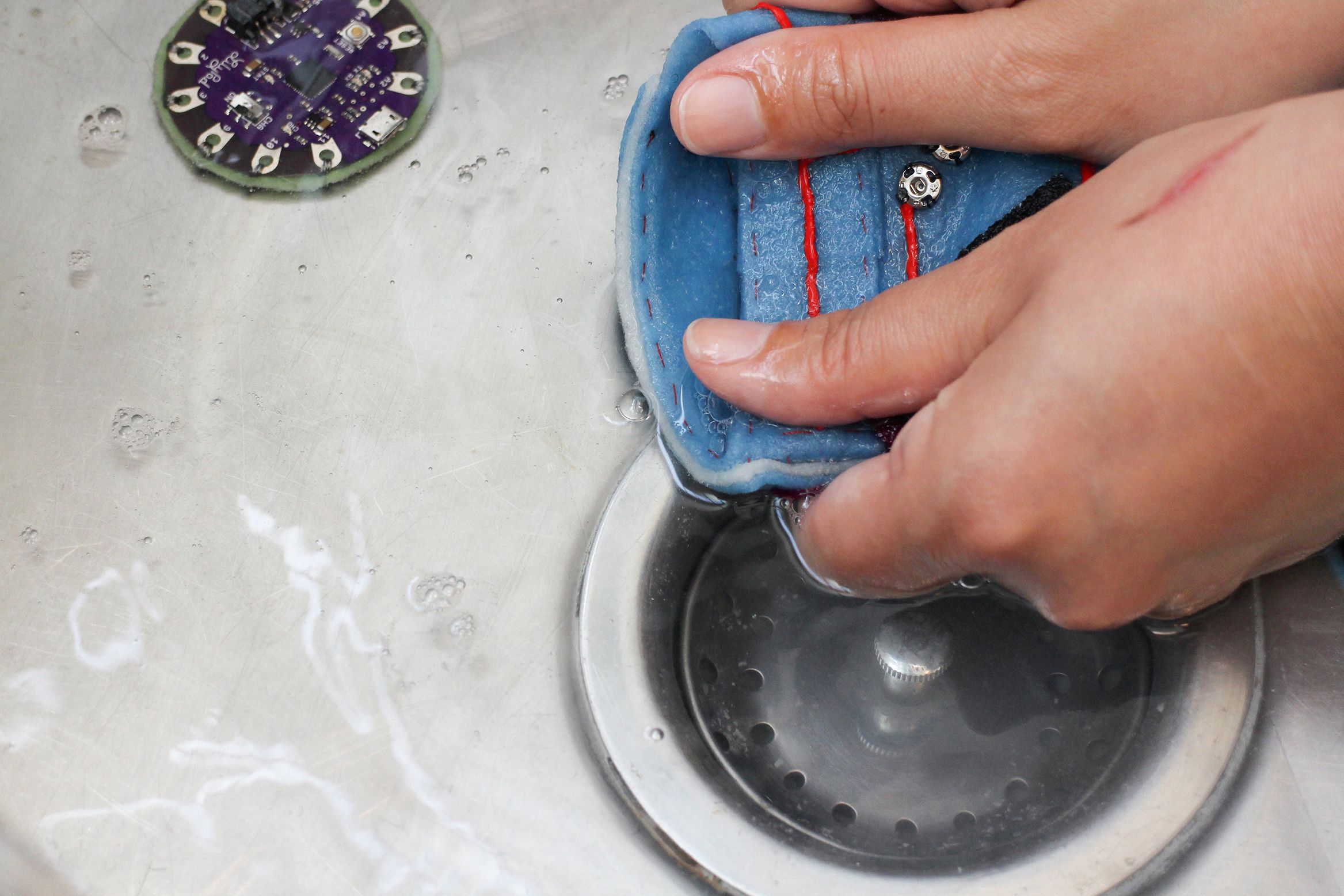

If a project seems delicate or is small and handmade I like to hand wash it. Delicate parts could be embroidery or connections that may not be that strong. Soldered joints can be delicate and some solder contains silver and copper which corrodes when wet and exposed to air.
Always dry your electronics completely as quickly as possible to prevent corrosion.

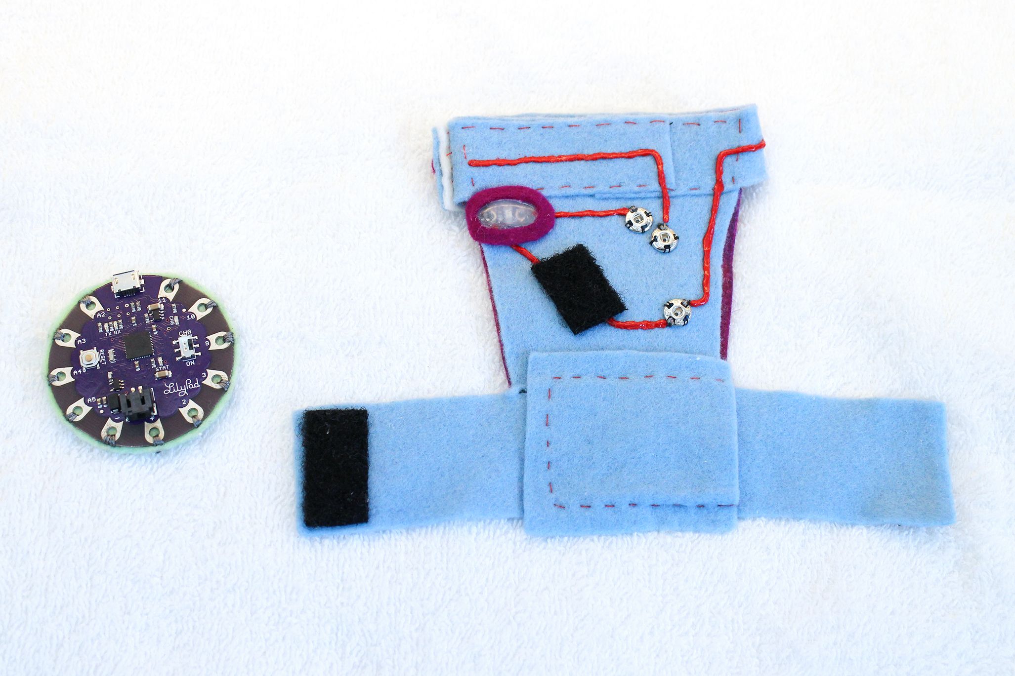

I recommend the same washing method for all the projects you make in this class because they are all made from 100% wool, a material that needs careful handling or it will shrink significantly. Follow along with the instructions I've illustrated using the Hi-5 Collector for washing all the handmade parts of your class projects.

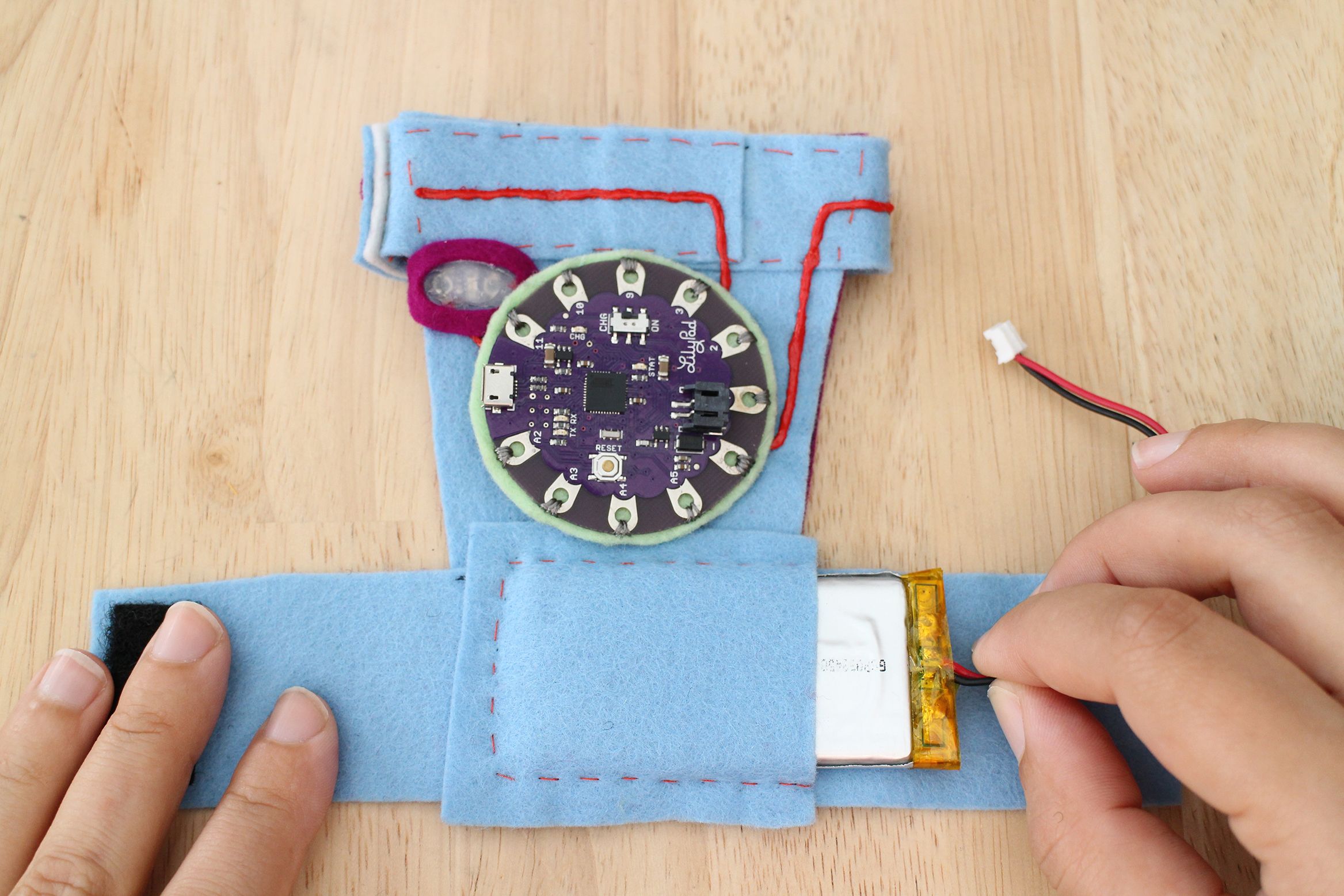

Remove the battery
. The LilyPad USB can stay on the project, but I recommend removing it to make cleaning and drying easier and faster. I recommend hand washing the Hi-5 Collector in cold water and air drying it. If there is a visible stain, I recommend spot treating the piece to preserve the shape of the project. This is because it's made of 100% wool that will shrink when heat and agitation are applied. It is also a non-woven material that can stretch out of shape while wet and if it's not kept an eye on. I do not recommend machine washing because since it's 100% wool. If you find that your project has shrunken a little, which I would expect from 100% felted wool, rewet the wool and stretch it out! That is the great thing about wool, it's very malleable.

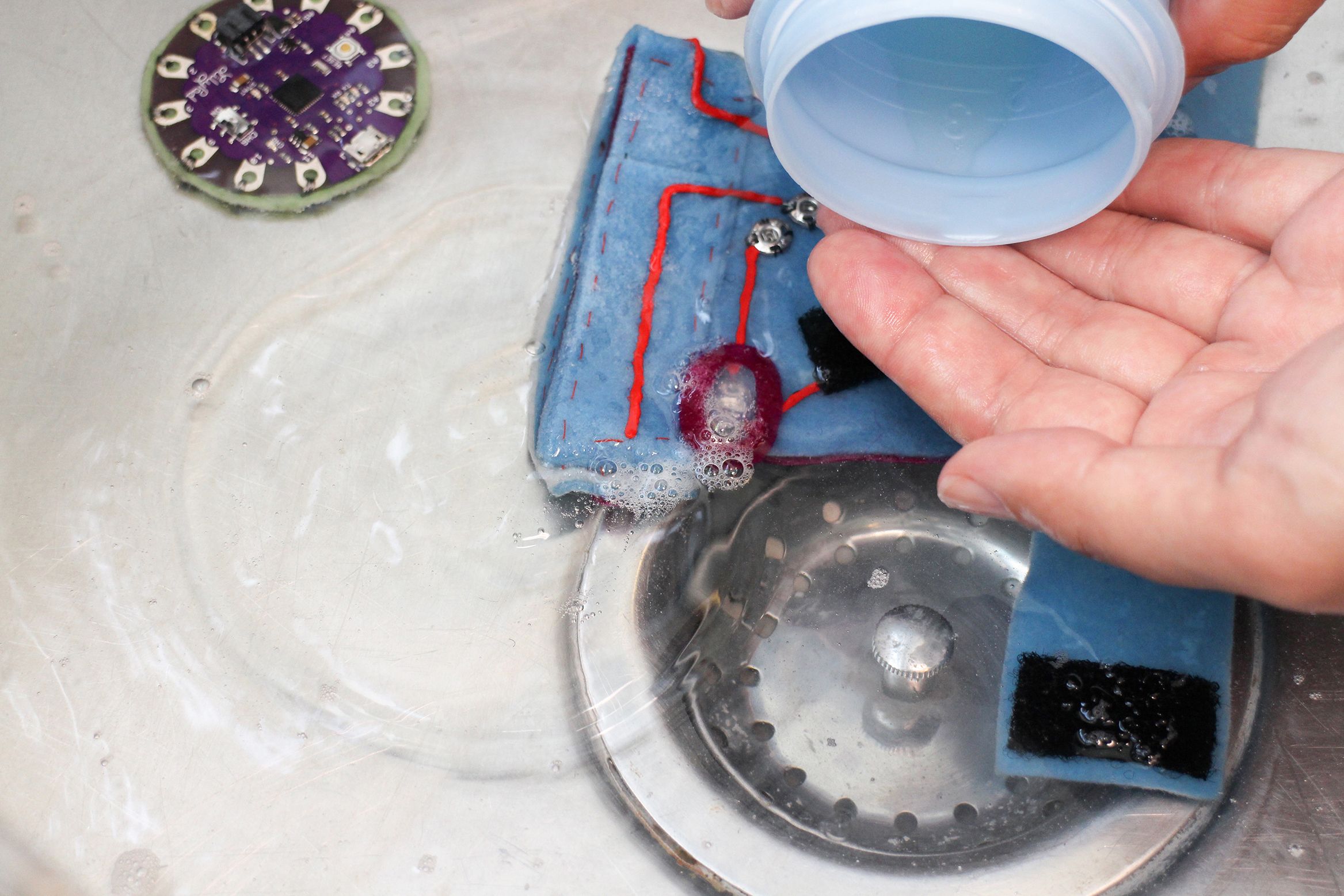

Remove the battery.

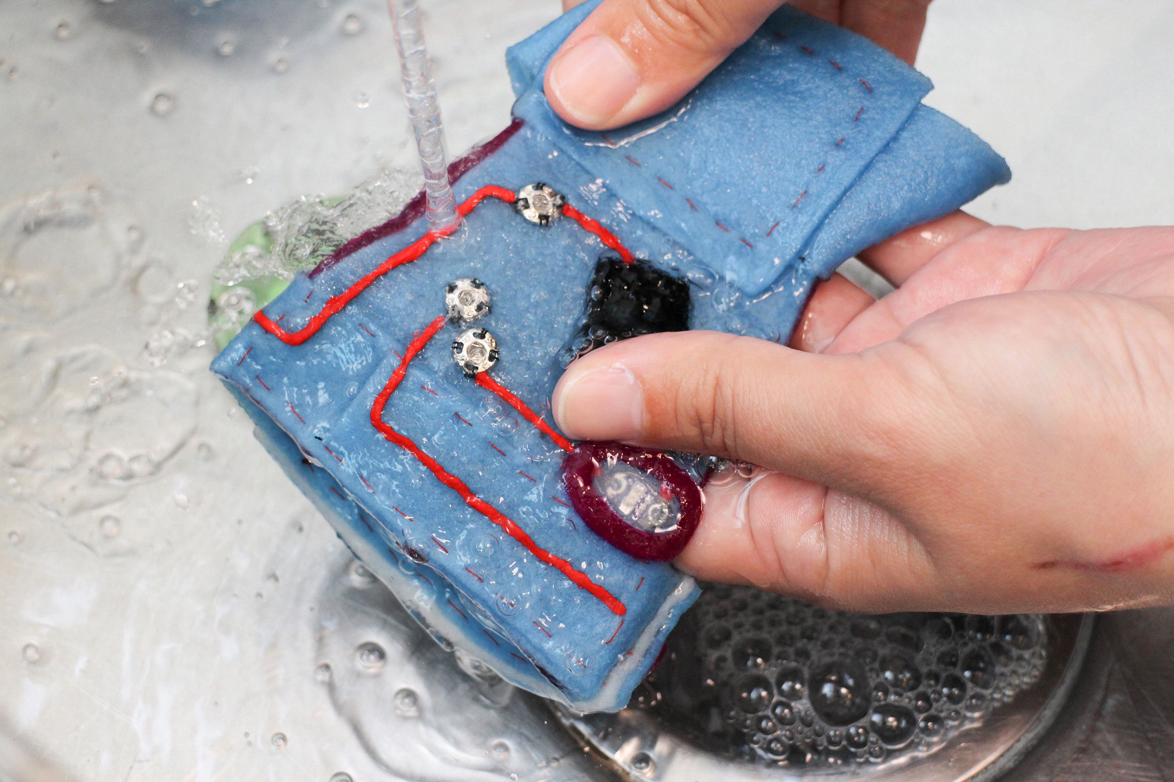

Get the project completely wet and aAdd a small amount of gentle soap.

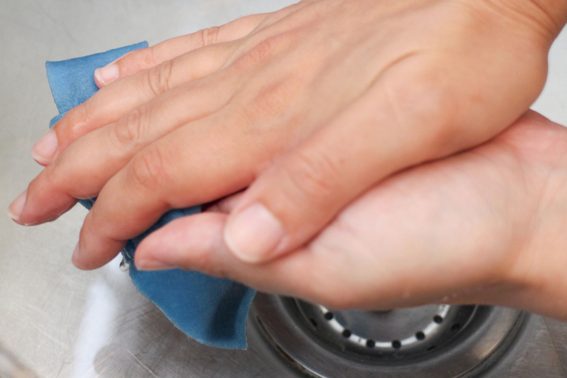

Lightly rub and swish the project in the soapy water freeing any dirt.
Drain sink and rinse the project under cold water.
Squeeze out all excess water.
Expect the project to shrink a little. Reshape while still wet and lay flat to air dry.

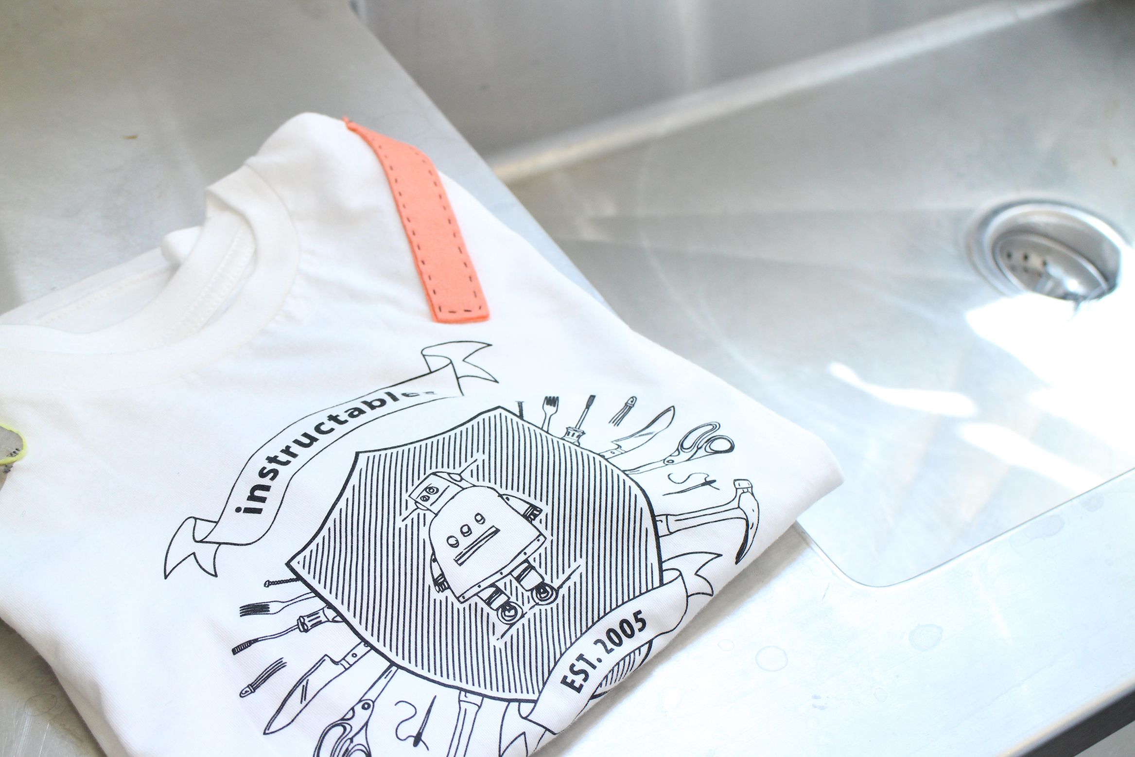

Even though the t-shirt's care tag tells me that I can machine wash it in cold and tumble dry on low I will hand wash it because of the 100% wool sensor and switch additions.
