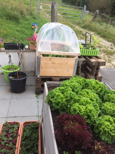

Winter is coming and in order to get some lettuces during the winter I created this greenhouse for my plantation boxes.
I hope you will enjoy this instructables this is the first of mine. Please provide feedback :)

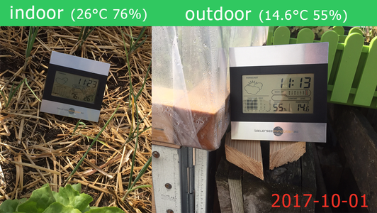

I did some measures to observe the difference of temperature inside and outside the greenhouse (third picture) and as you can see it seems pretty good.
Note: the measure were done with the greenhouse totally closed.

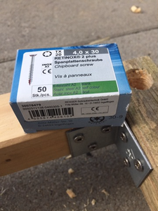

  • 2x wood 80cm
  • 2x wood 111.5cm
  • 4x angles (alloy)
  • 1x box - screws 4.0x30mm
  • 1x plastic tube (10 - 15 meters)
  • 1x plastic film

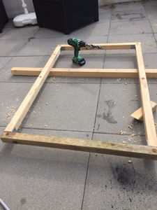

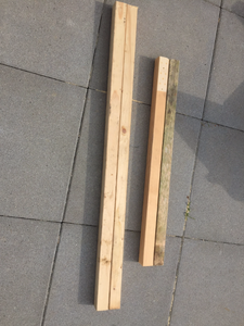

Step 2: Prepare 4 Stuck of Wood
You need to get 4 pieces of wood.
  • 2x 80cm
  • 2x 111.5cm

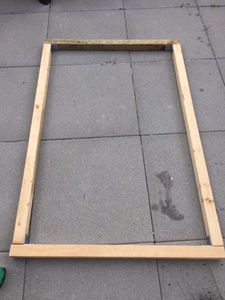

Step 3: Fix the Wood Parts Together With Angles
Simply rely the four parts together with 4 angles and screws.
In order to obtain something flat I recommend to do it on the floor (not vertically) that way you are sure (assuming your floor is flat.)

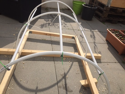

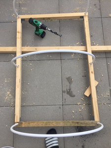

Step 5: Cut 3 Arcs
Cut 3 arcs of the same length in the plastic tube.
I used some tubes quite flexible take care when you buy yours that they are enough flexible
Step 6: Place the Tubes Into the Holes
Step 7: Fix Theses Arcs
With a screw fix the arcs simply by perforing the wood and then the tube will be like attracted to the exterior of the wood.
Step 8: Perfore the Top of Each Arc
Then you need to perfore the top of each arc that way we can attach the rest of the structure and we get sure it is not going to move.

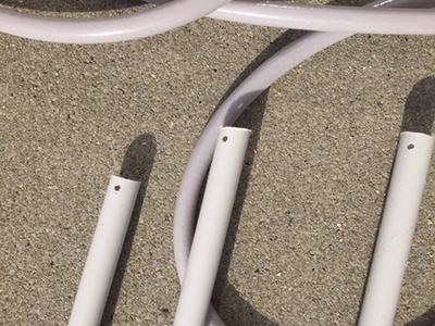

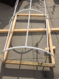

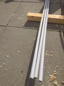

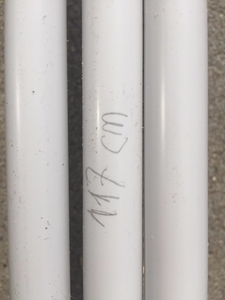

Step 9: Prepare 3 Tubes
You can cut 3 tubes of the same length.
All of them have to measure 117cm.
Step 10: Perfore Extremities of the Tubes
Perfore each extremity of each of the tree tubes.

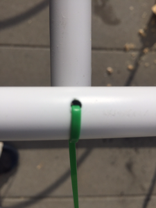

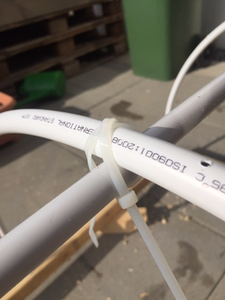

Step 11: Fix the Top Tube
Use the small holes we did earlier to fix all of it.
Step 12: Fix the Two Other Tubes
Exactly like previous step

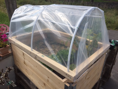

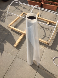

Step 13: Plastify
This part is the most difficult. In order to get good looking results you need to go slowly and carefully.

    Great Instructable! I have a question though. Is the plastic pipe regular PVC? One suggestion as well, you might consider using UV resistant zip ties (usually black). Regular zip ties last about 1 year in direct sunlight.
    0
    svermeille
    svermeille
    Reply 4 years ago
    Hi again I added the links to the plastic pipes description
    0
    svermeille
    svermeille
    Reply 4 years ago
    Hi Cheiron thank you :)
    I used two types of plastic pipe basically. One is formable (keep the form I give him). And for the lines one I used long plastic tubes.
    All of these are used in electric systems.
    I will add the link to my local shop products so that you can find some more informations about the products. ( I hope they are also in english :/ )

    A strong wind will eventually rip the plastic right through those staples.
    I would recommend sandwiching the plastic with extra wood strips so its held uniformly along its length.
    0
    svermeille
    svermeille
    Reply 4 years ago
    Hi ericCycles
    true it could. For this reason the peace of plastic is comming inside the house. That way the wind could not pass between the wood and the plastic. But sure it I have problems regarding it I will adapt this system to use your solution and update this instructables ;) Thank you for your suggest
