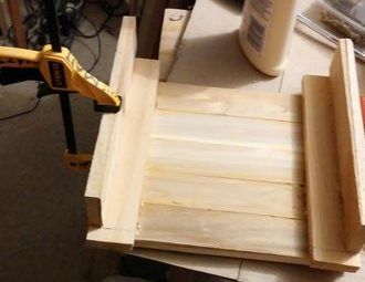

Step 1: Build Base
Build Base
1. Glue 2 wood shims together to make one solid piece.
2. Place 5 pieces of wood shims next to each other and connect with 2 crosspieces with wood glue.
3. On one end of both crosspieces, mark line for the place to glue pieces that will be the base for the rear wall of the structure. This will be about 1 cm or 1/4 inch from the end of the corsspieces.
Step 2: Start to Build Walls
1. Start to build the base of the side walls by gluing wood pieces vertically on the crosspieces.
2. Start to build the rear wall by gluing a wood shim piece to connect the 2 crosspieces.
3. Use clamps to hold them in place.
