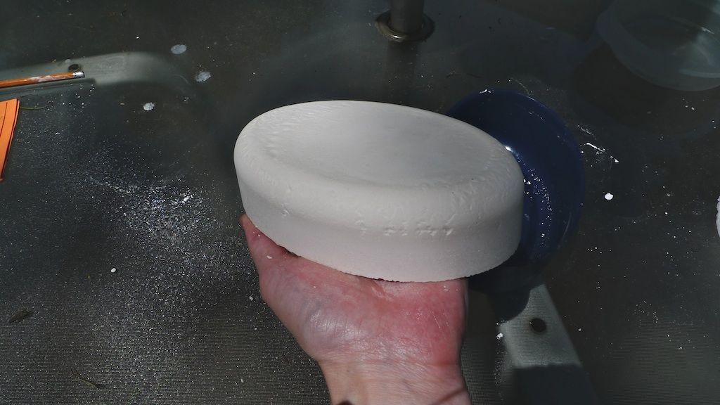

Introduction: Small Slab Roller for Ceramics
This will show you how I made my little cheap and easy slab roller for use with hump and slump molds to make bowls and dishes without a pottery wheel.
