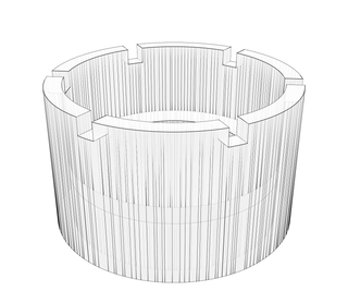

Step 4: 3d Printing the Lamp Post
3d print those files.
After 3d printing the files remove the supports.
