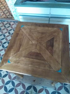

Step 2: Top
Make a frame with 45 degrees corners, fix with dowel-joints, and glue together.
Then add a layer of plywood fixed to the frame from the bottom. I used nails, and glue. I didnt have big enough to cover the whole area, but it was not needed; the ppieces were larger then the area not covered.
Then you can start to lay down your design.
As I was trying, I realized, that I could use the rounded end of the fence-wood to point to the corners, then I could fill the remaining area with some intereting material. Resin was in my mind at that point, but the fluorescent powder only came later in the shop.
I started to fit the 4 diagonal parts, and then cut to size the paralel parts. All parts ae glued to the bottom.
If you use fence laths, then you will realize, that its not staight enough to have a flat surface at the end :).
If you have a plane: use it to have a flat top. I didnt make it till perfection, but it doesnt have big differences between the parts.
I also rounded the corners with the router. Thas seen only on later pics.
Then sand it to the desired smoothness. Not sure, but I think I used 200 grid paper at the end.

Step 4: Add Glow in the Dark Resin
While working with resin, refer to the manuals, descriptions, and safety instructions.
Chek the drying time (or better pot time) of your resin, and only mix the quantity you can use in that time.
Otherwise you wont be able to use it any more.
I flle the wholes in two steps, as been advised in the shop:
First: clear resin till half volume to see leakage, and not to waste the glowing powder.
Second: mix the resin with the fluorescent powder, and fill the remaining.
Thats cruicial, that the holes should be sealed completely. Needless to say, that luiquid finds the way out. So make sure it cant.
So cover the surrounding area with electric tape, and pour resin into the hole. wait while it dries, and repeat with the fluorescent resin. It can be also a good idea to seal the wood before with lacquers, paint, or primer, so wood will not absorp that much resin.
