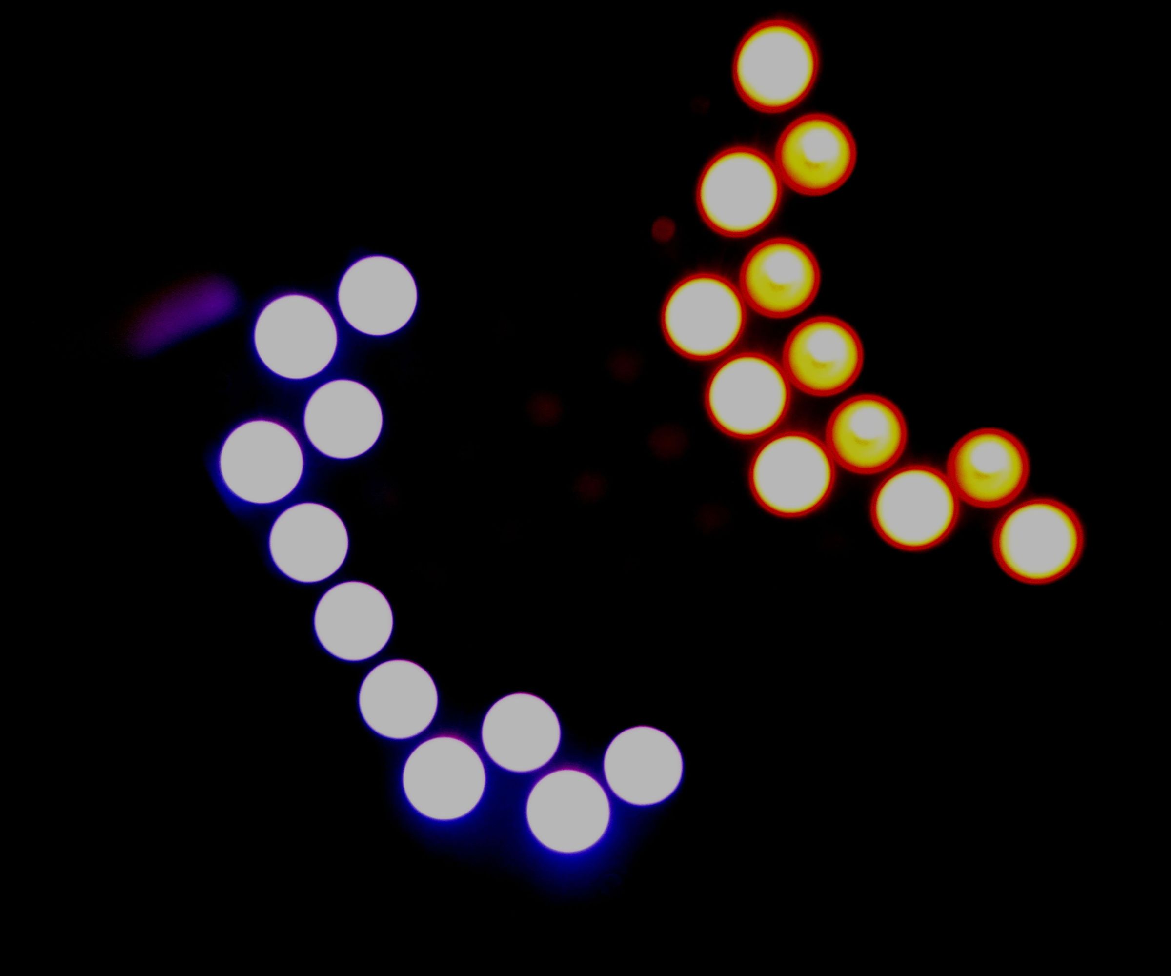

Venco is a device designed to be fitted in a centered, high-mounted position at the rear of a vehicle. It analyses the data from the sensors - gyroscope and the accelerometer and displays the current state of the vehicle - acceleration, braking to a halt, turn direction – through distinct signals and signs on one or several stackable LED matrices, thereby alerting other traffic participants and pedestrians. Sharing information that may be relevant to other traffic participants can improve traffic flow and safety.
