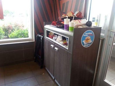

Imagine finishing a meal at a fast food restaurant and struggling to dispose of your trash into an already full bin. You might find yourself placing waste on top or leaving it on the table. Worse yet, you might wander around in search of an empty bin. These situations are inconvenient for customers and might harm the fast-food chain reputation for cleanliness and efficiency.
Fast food chains, which experience high foot traffic and generate significant amount of waste are particularly concerned. Overflowing bins create unclean environments, workers must frequently check and empty bins, diverting time from other tasks, making waste management a persistent challenge.
The idea of this project also comes from the personal experience of one of the Team Members. While still in the brainstorming phase, he went on a weekend trip to Amsterdam. There he had one of the best bitterballen he had ever tried, in a restaurant called Heertje Friet, right on the city center. However he found that, while this being a predominantly take-away spot, the only trash bin available was a public one located beside the shop, which can be seen in the picture above. It was overflowing. Lots of food containers, with the printed logo of the shop, thrown on the floor. Signals in the shop window explicitly asking to please throw the trash in the bin so it does not get into the canal. In short: a bad image for the restaurant and for the neighborhood.
The Smart Bin addresses these issues by providing an efficient waste management solution. It compacts trash, ensuring that the bin can hold more waste, reducing the frequency of emptying, and maintaining a clean, user-friendly environment for customers.

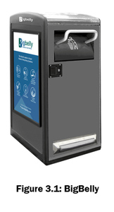

Bigbelly (Fifure 3.1)
• Strengths: Bigbelly is a solar-powered smart trash bin system that integrates automatic compaction and fill-level notifications. It is ideal for high-traffic public spaces like parks and streets, significantly reducing collection frequency and environmental impact.
• Weaknesses: The high initial cost makes it less accessible for smaller businesses, households, or low-traffic areas. Its focus is primarily on public spaces, limiting its applicability to other environments like offices or restaurants.

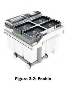

EcoBin (Figure 3.2)
• Strengths: EcoBin specializes in waste segregation, supporting recycling initiatives by separating materials like paper, PMC (plastic, metal, cartons), and organic waste. It also includes smart fill-level notifications, which optimize collection schedules. EcoBin is highly customizable for settings like campuses or offices
• Weaknesses: While EcoBin excels at waste separation, it lacks compaction technology, limiting its ability to handle large volumes of waste. Additionally, its cost is relatively high, which may deter small-scale users such as restaurants.

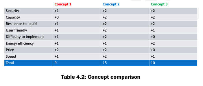

The Table 4.1 shows our morphological chart with 3 concepts generated
Our concept generation process was structured and iterative
  1. Ideas generation for each feature
  2. Smart bin mechanism study in existing products, analyzing their strength and limitations
  3. Exploring several mean to achieve each feature
  4. Multiples sketches to visualize and refine potential designs
  5. Generation of 3 concepts and made final sketches
Based on the comparative table shown on Table 4.2, concept 2 emerges as the most promising option, scoring the highest in safety, liquid resilience, user-friendliness and cost-effectiveness. The design is well suited for the goals of the project: it optimizes customers and workers satisfaction, provides reliable compaction, and integrates into fast-food environment.
  1. Scissor lift with linear actuator provides a robust yet energy efficient method to achieve high compaction force. The design ensures a good balance between the pressing force and the speed of operation.
  2. Lock during compaction prevent access during compaction
  3. Vertical compaction ensures more trash capacity
  4. Pull-to-open door prevent the door to interfere with the compacting mechanism
  5. Fill level at a certain level permit to place the sensor on the side of the bin
  6. Liquid management is ensured by putting all electronic components in a separate room
  7. Battery power supply offers reliable and cos-effective operation
  8. Ultrasonic sensor is chosen for its precision and reliability
  9. Compaction completion with current sensor ensures that the system stops compacting once the required force is achieved to prevent overloading.

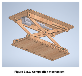

1. Compression mechanism
The compression mechanism is determined as a one stage scissor lift. These types of mechanisms transform a linear displacement of a linear actuator (also called stroke) into a greater displacement in a perpendicular direction of the mechanism. In other words, increases the stroke of the mechanism, reduces the force and changes the direction of displacement. In Figure 5.2 it can be seen the design of the compression mechanism of our project (the grey part is the linear actuator), one end is fixed to the structure and the other end is the compression plate that is in touch with the trash.
The next figure is a gif that illustrates the functioning of the mechanism. It can be seen that there are 3 pivot joints and 2 other sliding friction joints. The detail of the joints can be seen on Figure 5.3: the parts in yellow are washers and flanged plain bearings made out of a low friction mechanism (such as nylon) and the part in blue is a spacer sleeve to correctly place the scissor arms.

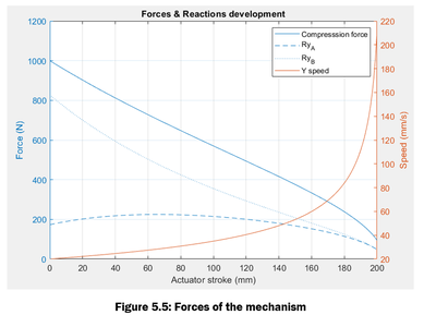

The dimensions of the mechanism chosen for the project can be seen in Figure 5.4. The minimum geometry to define the kinematics of the mechanism are the dimensions b, c and h. c also corresponds to the stroke of the actuator. In the design phase there were two different actuators to choose from:
  1. Stroke of 200 mm and 750 N force
  2. Stroke of 100 mm and 900 N force
Both with similar travel speeds and powers. It was decided to use Option 1, 200 mm stroke, in order to obtain a greater displacement in the scissor lift, and to be able to make a deeper trash bin in which more garbage can fit. It also features a speed of 20 mm/s, so it takes around 20 seconds for the mechanism to expand and retract.

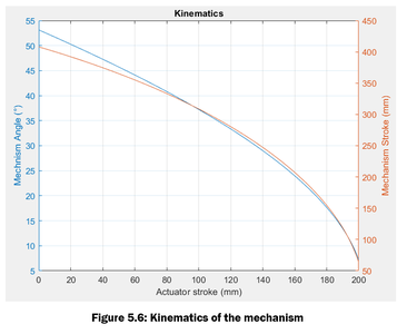

The deduction of the equations of the kinematics and dynamics of the mechanism is outside the scope of this report. A reference page for its calculation can be found here, and the Matlab script created to do the calculations can be found in the project file repository under the name MechanismForces_MECHX.m.
The results of the kinematics and dynamic performance of the mechanism is shown on Figures 5.5 and 5.6. To read these graphs it is important to take into account that when the actuator (X axis) is fully extended (200 mm) is when the mechanism is retracted. Several things can be concluded out of these results:
  1. The compression force keeps increasing while the mechanism expands (Figure 5.5). This a good result, as in our design, the mechanism starts advancing without resistance and it is not until the last range of the mechanism displacement when it encounters trash (and therefore resistance).
  2. The reaction at point B (the sliding joint) can get as high as 800 N. Knowing the coefficient of friction, the force friction could be calculated.

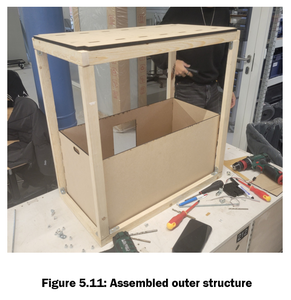

5. Outer structure
It is the subsystem that hold the rest of the subsystems in place. As it can be seen in Figure 5.14, originally it was going to be made out of aluminium extruded profile 20x20, but due to not having enough available material, it had to be changed to rectangular wood bars. In Figure 5.10 it can be seen a detail of the joints, and in Figure 5.11, the real outer structure already finished. The dimensions are 620x320x605 (Width x Depth x Height).

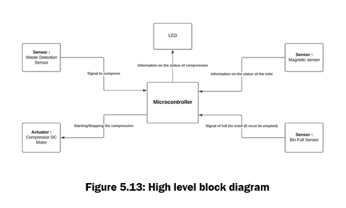

High level block diagram
The high level block diagram can be found in Figure 5.13.

1. Compaction mechanism
This is the main and most demanding mechanical system. It can be seen in Figure 6.a.1 of the section. The forces it have to withstand while compressing are quite high (they were calculated and explained in the previous section), so after a couple tests with the available materials in the Fablab (basically MDF of 3 mm or 4 mm), it was determined that a thicker material was needed to avoid buckling or tearing. The first option was to stack 3/4 mm sheets or buy a thicker one. For simplicity and to improve tolerance of fittings, it was decided to use a bought 8 mm MDF sheet. It was quite challenging to cut it with the available laser cutters, but with 2 mm/s speed and reducing the focal distance to 10 mm it was achieved.
The main structural parts of this system are named (Figure 6.a.2):
  1. Scissor Plate Upper (x1)
  2. Scissor Plate Lower (x1)
  3. Scissor Slider (x4)
  4. Scissor Structure Arms (x4)
As mentioned, all of these parts are made out of 8 mm laser cutted MDF, as they are plane pieces and need to withstand forces.The scissor sliders were glued together (Figure 6.a.3) to the corresponding upper/lower scissor plates .

  1. Linear actuator (x1)
  2. Threaded rods M6 (x5)
  3. Spacers (x4)
  4. Plain bearings (x20)
  5. Thrust washers / Low friction washers (x20)
  6. Nuts M6 DIN 934 (x24)
The linear actuator was provided by the Fablab, so most part of the decisions surrounding this part are defined by it's geometry.
The rest of the parts mentioned above allow the pivoting, rotating and sliding of the mechanism. Using threaded rods was the simplest way of holding the structure together and allowing relative rotation of the mechanism. The chosen diameter (M6) was the maximum allowed by the already made holes on the linear actuator. (Figure 6.a.4)
Friction in a mechanism that withstands forces is crucial. The plain bearings and thrust washers were, at first, intended to be commercial parts made of a specific plastic material that reduces friction. This were to be provided by Igus, a German company that distributes these types of components for specific applications in robotics and automation. However, after a talk with the Fablab staff, it was determined that the cost of those parts were excesive for the use we were going to give them, so the plain bearings were 3D printed out of PLA and the thrust washers were substituted by wide flange washers (DIN 9021 M6, made out of regular steel). The joints were lubricated with lithium grease made for bearings, so friction could be brought down to a minimum.
2. Outer structure
As mentioned on Section 5: Embodiment Design, the outer structure was originally going to be made out of aluminium extruded profile 20x20 to give the prototype more stiffness and to allow easy mounting of extra features on the outside. It would also allow to be the outer structure reusable: just disassembly the whole prototype when the course is finished and use the profiles for future projects. However, the Fablab did not have enough profiles to build the entire structure, and it was to expensive for the team to buy them. Therefore, it was decided to buy 19x32 wooden bars and brackets, mounted as seen in Figure 6.a.6. Finally, approximately 6 meters of wooden bar were used.
This allows some ease of disassembly, as wood screws can be mounted/unmounted several times, but the structure ended up lacking stiffness and most importantly, geometrical tolerances. The trash bin should fit snugly inside the outer structure, but in our case it ended up fitting too tightly, with no room for adjustment.

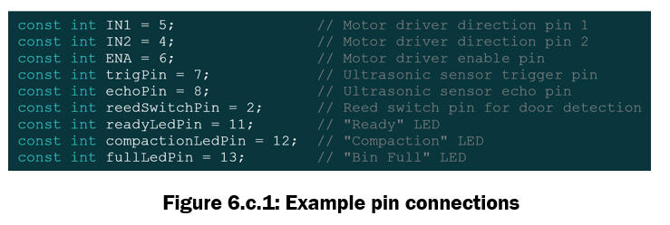

To make the LEDs functional, 220-ohm resistors were used, and three pins, pin 11 for the green LED, 12 for the yellow LED and 13 for the blue one, were assigned on the Arduino.

Example Pin Connections can be found in Figure 6.c.1.

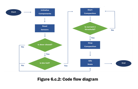

The code flow diagram can be found in Figure 6.c.2.

// Motor driver pins
const int IN1 = 5; // Motor direction pin 1
const int IN2 = 4; // Motor direction pin 2
const int ENA = 6; // Motor enable pin
// Ultrasonic sensor pins
const int trigPin = 7; // Trigger pin
const int echoPin = 8; // Echo pin
// Magnetic reed switch pin
const int reedSwitchPin = 2; // Pin for magnetic reed switch (door)
// LED indicators
const int readyLedPin = 11; // LED for "ready"
const int compactionLedPin = 12; // LED for "compaction ongoing"
const int fullLedPin = 13; // LED for "bin full"
// Thresholds
const int fullDistance = 50; // Bin full distance threshold (in cm)
const int compactionDuration = 20000; // Motor compaction/retraction time (in ms)
const int ultrasonicBlockTime = 3000; // Ultrasonic block duration to trigger compaction (in ms)
const int fullBinDelay = 5000; // Delay to check if bin is still full after compaction (in ms)

Step 2: Microcontroller and Sensor Integration
  1. Ultrasonic Sensor (HC-SR04):
  2. Connected VCC and GND to the 5V and GND pins of the Arduino.
  3. Connected Trigger and Echo pins to digital pins of the Arduino.
  4. Configured the Arduino to calculate the distance based on the sensor’s pulse time.
  5. Magnetic Reed Switch:
  6. Connected one end to the GND pin and the other to a digital input pin on the Arduino.
  7. Programmed the Arduino to monitor the door state and generate interrupts during operation.
  8. LED Indicators:
  9. Connected LEDs to digital output pins via 330-ohm resistors.
  10. Assigned each LED to represent system states (Ready to Use, Compaction, Bin Full).
Step 3: Motor Driver and Actuator Integration
  1. Connected the XY-160D motor driver to the Arduino:
  2. IN1 and IN2 pins connected to digital output pins on the Arduino for direction control.
  3. PWM pin connected to a PWM-capable pin for speed control.
  4. Wired the Linear Actuator to the motor driver output terminals.
  5. Tested actuator movement by sending directional signals (HIGH/LOW) from the Arduino to the motor driver.
Step 4: Programming and Logical Integration
  1. Code Deployment:
  2. Uploaded the Arduino code for system logic, including:
  3. Distance measurement and level calculation from the ultrasonic sensor.
  4. Door state detection and interrupt handling.
  5. LED state transitions based on operational conditions.
  6. Motor control signals for the linear actuator.
  7. Subsystem Coordination:
  8. Programmed the Arduino to monitor the bin level and activate the actuator when full.
  9. Added logic to pause compaction if the door opens (based on magnetic switch input).
  10. Ensured all LED indicators responded dynamically to their respective states.
Step 5: Physical Assembly and Wiring
  1. Mounted all components securely within the bin structure:
  2. Placed the ultrasonic sensor at the right side to face the trash level.
  3. Installed the magnetic switch at the door .
  4. Mounted the linear actuator and scissor lift mechanism within the bin for compaction.
  5. Routed wires neatly to prevent interference or accidental disconnection.
  6. Secured the Arduino, motor driver, and power supply in an accessible compartment.
Step 6: Integration Testing
  1. Powered on the system and verified stable operation of all components.
  2. Tested the interaction between subsystems:
  3. Confirmed ultrasonic sensor readings triggered the compaction process.
  4. Ensured the magnetic switch paused the actuator during door interruptions.
  5. Verified LED states transitioned appropriately during all operations.

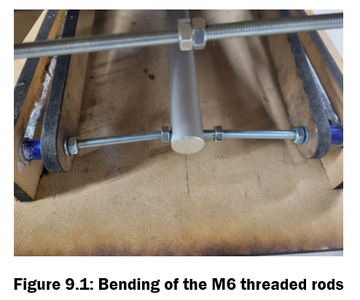

Perhaps the biggest flaw that the prototype has is the stiffness of the compression mechanism. When the calculations were made of the forces that the structure had to withstand, they were made taking into account that everything would slide and move straight, that there would be no misalignments or variable disturbances during compression.
The calculations were made thinking especially about the arms of the structure, and that is why they were tested and it was decided to increase their thickness to 8 mm. However, nothing was tested or calculated for M6 threaded rods. When we were testing the entire prototype, taking it to more demanding conditions, we realized that the rods began to bend, as seen in Figure 9.1 and that they caused significant misalignments, which in turn caused the washers to tear the part of the slot through which the mechanism must slide, as seen in Figure 9.2.
All these problems came up when testing the final prototype, during the last two weeks of work in the Fablab, and constantly assembling and disassembling the entire mechanical part generated a workload and a bottleneck that made it impossible to properly test the electronic part of the project. These problems could have been foreseen in the time organization of the project, and that would have been the main point of improvement that would have made the prototype work flawlessly.

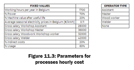

The prices for the Materials and Fasteners can be found in Figure 11.1, and were estimated based on prices available on brico.be or in other sites on the internet.
The price estimation for the Processes takes into account a lot more parameters, that are shown on Figures 11.2 and 11.3. The cost of a Process is basically divided in 3 parts:
  1. Labour cost: takes into account the type of operator (and therefore his salary) that carries out the process and other indirect costs such as taxes.
  2. Depreciation cost: takes into account the price of the machine, it's service life and depreciation over the years.
  3. Energy cost: takes into account power consumption of the process and energy cost.
There are many other parameters that are still being left out from the hourly rate for a process, such as the maintenance costs or the price of the surface the machine occupies.
As the prototype is mainly done using laser cutting and 3D printing, these are the only Processes considered, plus a third one that covers the machine set-up (loading the file, checking that everything starts working correctly, cleaning it...).
Finally, in Figure 11.5, it can be seen how the cost of every part is computed. The full table can be found in the excel file available in the repository.
The total calculated cost of the prototype is 165.33 €. It is kind of expensive, but it has to be taken into account that most of this price comes from the linear actuator and electronics, that can be disassembled and reused for future projects.
