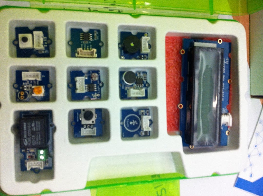

We used the
-LCD display
-Light Resistor
-Push Button

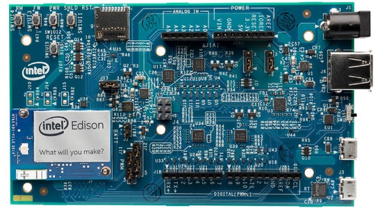

Consideration for Intel Edison Board
We used the Edison board. To get started, we needed to do some settings.

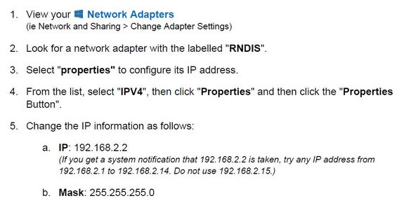

1. Connect the Edison to Wifi
- Before you connect, go into the setting of network setting of your computer. In the properties section, you need to set the ip address.
- In the putty, use the instruction 'configure_edison --wifi'
cf) if the putty is not working check the settings again.
2. if the edison board is not working, update the image file of the edison board. It will figure the most problems.

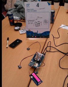

Step 3: Connect the Sensor
We added 5 header file to connect the sensor.
Through the picture, you can notice which header file used each sensor.
For more help, when you add the header file such as mraa.hpp, you need to correct the settings.
-Settings- properties- find the location of header file located - add the 'mraa'

Step 6: Finish
When you done with these steps.
You can see the counts are going up when you press the button and when you touch the light sensor, led will turn on
