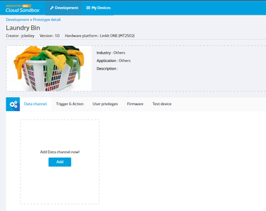

Step 3: Create Your MCS Project
If you're unfamiliar with MediaTek's Cloud Sandbox, I suggest you go read up on it here. Hopefully you have already created an account so we can jump right into the project scene.
You'll want to create a new project under the development tab. Follow the images above as a guide for what exactly you need to set up. Remember to write down your DeviceID and DeviceKey, as we will need those later in order to connect to our account from our LinkIt One.

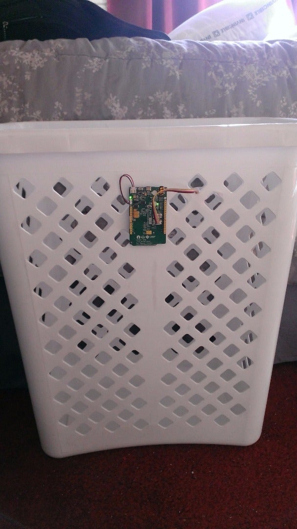

Step 6: Deploy Hardware
Using some tape, attach your LinkIt One to your laundry basket. The battery is pretty light, so even regular old scotch tape will do (for more long-term projects, you might want to use duct tape or hot glue of some kind).
Make sure that the sensor is pointing down the basket, so it can accurately tell if the basket is full or not.
