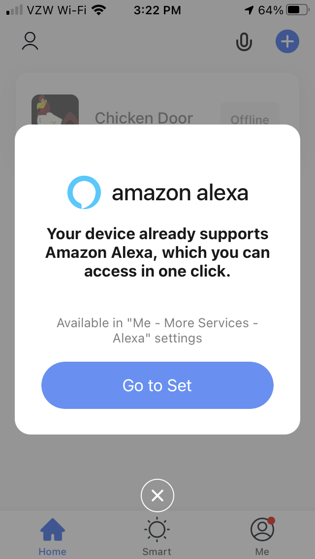

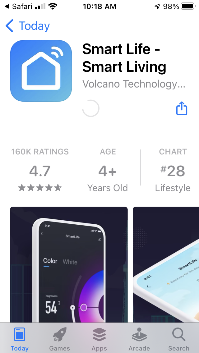

Step 1: Smart Phone App
First step is to ensure that your garage door controller is working with your network and smart phone.
Depending on the garage controller you purchased, and there are quite a few, the app maybe different. I bought the controller and it said to install "Smart Life" then next time I purchased it said to use "eWiseHome". Both apps had the same features and functionality.
In general, you will follow the instructions that came with your garage controller. The video is a quick overview of the process to connect the controller to your phone and network. It is very easy and essential for this project.
Typically these controllers cost about $25 - $30 and come from variety of manufacture names.

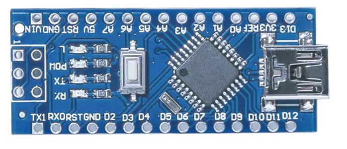

Step 2: Program Arduino Nano
Here is an Instructables on how to get started with your Arduino Nano
https://www.instructables.com/Arduino-Nano/
But, assuming you already know how to program your Arduino, download the chicken coop code from GitHub. I've also attached the current version to this instruction as of writing, but the latest will always be on GitHub.
https://github.com/CodeMakesItGo/ChickenCoopDoor/blob/main/chicken_coop/chicken_coop.ino
Step 3: Flashing LED
Next we are going to ensure the Arduino Nano is running the application. The application has a heart-beat indication. This just blinks an LED at 1Hz to let you know the program is running and it is "alive".
  1. Connect an LED to D5 on the Nano and a 220ohm resistor in series. The resister can either go on the ground side connecting the LED to ground or in between the D5 pin and the positive side of the LED. As a reminder, the negative side of the LED will be indicated by the flat side of the LED bulb.
  2. Connect the USB cable to the Nano, if the LED is blinking, the application is running.
At this time, you should also connect the Door sensor LED to pin D6 (as indicated in the diagram). This LED will indicate when the door is closed and will help prove the door sensor is working at a later step.

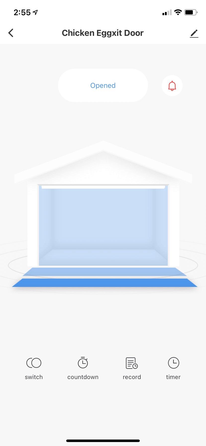

Step 7: Garage Door Switch
Now on to the garage door controller. Assuming you bought the USB powered garage door controller, you can either use the power supply it came with or strip the USB cable and use the 5V voltage regulator to power it. Up to you.
  1. The garage door controller should be already setup from step one. Ensure that it still connects to your smart phone after you power it on.
  2. Connect the garage door toggle switch (two wires) to the Arduino. One wire will go to GND and the other to pin D2. It does not matter which wire goes where, it is simply just connecting D2 to GND the same as we did in step 5 to test the relay.
  3. Ensure everything is powered on and use your phone to toggle the relay direction by manually opening and closing the garage door on your app.
In the diagram, the garage door controller is not pictured but the connection is at the top right corner.
