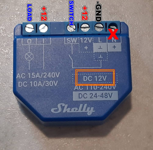

Wire strippers, Crimpers, jewelers flathead screwdriver, cap crimps, Voltmeter, and of course the Shelly 12VDC capable smart relay. It MUST be the Shelly 1 Plus that can be powered by 12 volts DC, usually around US$20 each at current time. I have labelled the connections used, the last one on the right will not be used.
Step 1: Prepare the Relay
Prepare the smart relay by cutting and inserting wires as shown, you will need 2 wires for the + 12VDC (shown here in red), a wire to connect to the original switch with female spade lug on the other end, and a wire for the -Ground (other end stripped bare). Use the flathead screwdriver to firmly tighten the connectors for each wire. Also cut another jumper wire that will go from the main -Ground wire(s) to the switch with a female spade lug on one end and stripped bare on the other (not shown). Again, the farthest right connection will not be used.
