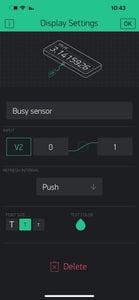

In the blynk app, we choose the "Value Display"(photo 2) option and define it according to the second photo with any input value you want (we chose V2)(photo 3).

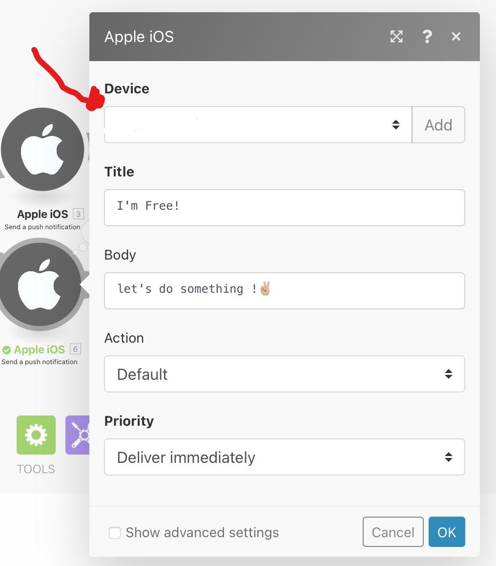

Third. Now we will define the notification messages for two possibilities: free and busy(photo 5 and photo 6&7 shows the message to the contact ). Also, we will use the circuit-cpx lights for alert: when busy- red, free-off(photo 8). So we can put the circuit somewhere closed by so the people around you will know your status.

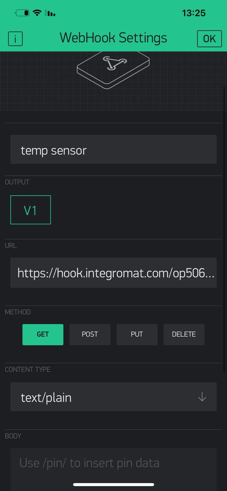

In the blynk app we choose the Gauge- temperature which has been measured and WebHook- the URL which later we will update (photo1&2).
V0- tempertue that been measured
V1- the value that has been made sends to intergomat

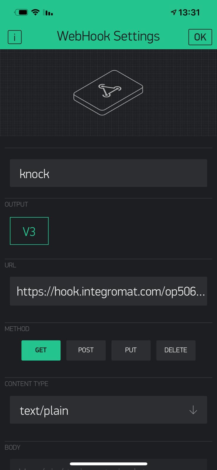

first, in the blynk app we will choose the WebHook URL which later will be updated
V3 - decibels that have been measured
In the intergomat app we do as in the previous feature:
  • open a new scenario
  • choose the trigger to be WebHook
  • connect to it our device - apple IOS
  • copy the URL to the WebHook in the blynk
  • add: ?param to the end of the URL
  • set the filter param to yes (picture2)
  • use the following code to Arduino( in the last step)
In the WebHook we will define what to send whenever there is a knocking event(picture3)

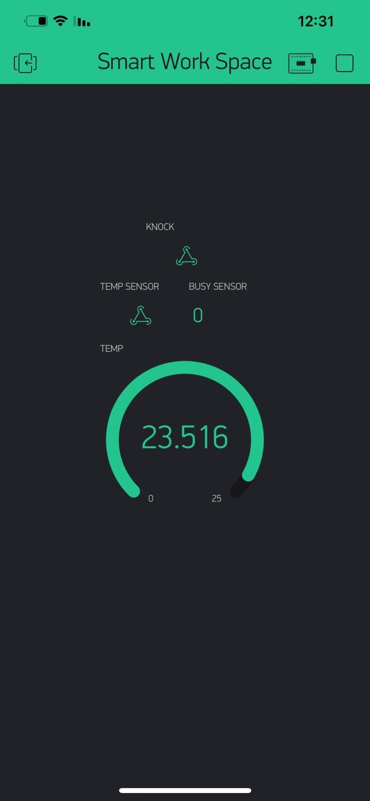

the sensor on the screen which measures the decibels in the room(picture6)
Step 6: This Is How the Final Blynk App Should Look Like, Barcode to Our Blync App and the Final Arduino Code
