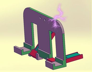

Through travelling by plane, I came across the difficulty of holding your smartphone while you want to enjoy your favourite Japanese anime episode :) You could hold it by hand but it gets tiring quite fast; I am sure most will agree! So I came up with this simple holder to 'hang' it from the tray table's locking mechanism found on most planes.

The first bit of work that should be done is of course printing everything that will be needed to assemble this. Note that everything fits together straight after 3D printing! No extra materials or fabrication is needed, apart from a small piece of string (I found that thick fishing line works really well but I will leave this down to your creativity!)
This smartphone base can be used best if printed using flexible rubber-like material. This will ensure that:
- the parts fit together easily
- the base does not break (e.g when carried in your rucksack)
- protect the smartphone from scratches etc.
In total you will be printing:
- x1 main plate
- x2 female supports
- x2 male supports (fit into the female supports)
Step 2: Assembly Time
Now that everything is printed just put the pieces together. You will find square and circular holes on the main plate where the female supports can be fitted. Subsequently fit the male support into the female ones; therefore now the supports are extendable allowing freedom of adjustment to accommodate the various types of plane seat trays.
As a last step you will need to attach a small string in the 2 holes of the plate to create a small loop; this loop will be used to 'hang' the base from the tray's locking mechanism.
Step 3: Can Be Used in Both Open and Closed Tray Positions
Anyone can have a preference of watching something on their phone when the tray is either folded or open. Because the back supports can be extended and the base hangs from the lock of the tray, it can be used equally well in both cases!
