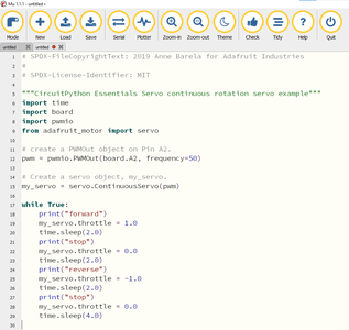

Step 2: Download Continuous Circuit Python Code
For this step of the project, students should install and set up the circuit python bootloader onto their computers and then work through the steps to obtain the code for this project. They will then be able to control the CPX using the code.py file which will eventually cause the servo to express its desired motion. Steps for downloading and setting up the code for this project can be found by visiting the following link: https://learn.adafruit.com/circuitpython-made-easy-on-circuit-playground-express/first-things-first. There are essentially 3 things that students need to do to have success with this aspect of the project. First, download and install the Mu editor: https://codewith.mu/. Second, download the CircuitPython Bootloader from https://circuitpython.org/board/circuitplayground_express/ and drag it to your CPX (CPLAYBOOT), it will change to CIRCUITPY. Third, set up your CircuitPython Library by extracting the folder onto your own computer from the following link: https://circuitpython.org/libraries. Students should find the files titled adafruit_circuitplayground & adafruit_motor in the lib folder and copy them  into your CPX lib folder. Keep track of the location of this big folder later as it will be helpful if you wish to move other libraries onto the CPX. Once you have all of this stuff setup, you can download the continuous servo code from https://learn.adafruit.com/circuitpython-essentials/circuitpython-servo which will be used to make the smiley face in our design spin in future steps. This is the second section of code on this website so be sure to copy and paste that one and not the first one into your Mu editor before loading it onto your CPX in future steps.

Step 4: Load Circuit Python Code From Computer to CPX Device
For this step of the project, students should transfer the code that is stored on their computer into the CPX device using a USB A micro cable or any other compatible cable. They should follow the instructions underneath our coding section above in order to have the proper type of code on their CPX device. This will allow for the CPX to control the servo’s motion for the future steps of our project.

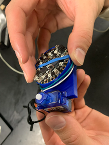

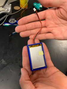

Step 5: Place Battery Into the Battery Pack
For this step of the project, students should place the battery into the 3D printed battery pack and allow the wire to go through the open slot on the end. This will assure that the battery is stable and can be used to power the motion of our servo through the CPX device in future steps.
Step 6: Attach CPX Holder to Battery Pack With Rubber Band
For this step of the project, students should twist a rubber band 2 times around both the CPX case and the battery pack to connect them together. This will assure that these two components of our design stay locked together so that they can function properly alongside each other. Also, the rubber band in this position will later act as a holder for the wristband that we will be adding in future steps.

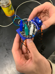

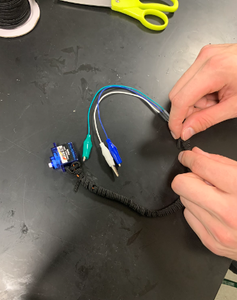

Step 7: Attach Alligator Clips to Sirvo Extension Wires
For this step of the project, students should attach the alligator clips to the servo’s extension wires in any order that they please by simply sliding the wire into the slot. In our pictured example, the white clip goes to the brown wire, the blue clip goes to the red wire and the green clip goes to the orange wire. These combinations will be important to remember when we attach the other end of the alligator clips into our CPX to allow for the servo to obtain the code for its desired motion.
Step 8: Wrap the Extension Wires to Form the Wristband
For this step of the project, students should take an unbelievably lengthy portion of the black elastic band and wrap it along the servo and alligator clip wires to form the wristband for this design. They should do this by first tying a knot at the servo end of the wires, then double wrapping the black elastic band along the length of the servo wires, and then finally tying another knot at the alligator clip end of the wires. This will allow for a durable, comfortable, and adjustable wristband design that can be wrapped around the wrist and connected to the CPX case in future steps of the project.
Step 9: Gorilla Glue Sirvo Attachment to Battery Pack
For this step of the project, students need to put a layer of gorilla glue or hot glue on the side of the servo and press it onto the side of the battery pack. They should hold these two pieces together for a minimum of 3 minutes to ensure that proper adhesion takes place between these two components of the project. This will allow for the CPX device, battery, and servo to all be interconnected in one device that can be worn around the wrist once the wristband is completely attached in future steps.

Step 12: Attach the Alligator Clips to the Corresponding Nuts and Bolts
For this step of the project, students should attach the alligator clips to the corresponding nuts and bolts that will allow for the uploaded code to be transferred from the CPX device to the servo so that motion can occur. They should do so by recalling their color coded wires from the previous steps and then lining them up based on what their code calls for. In our pictured example, the white clip attaches to A2, the green clip attaches to GND, and the blue clip attaches to VOUT, and students should reference this image to make sure the wires are connected correctly. This will allow for the code to be properly transferred from the CPX device to the servo once the battery is connected in a future step, allowing for the desired motion to occur.

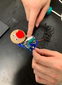

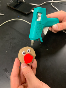

Step 13: Build the Smiley Face Using the Glue Gun
For this step of the project, students should cut out a piece of cardboard that is the same size as the CPX device, and then use the glue gun or gorilla glue to attach eyes and a nose to the cardboard to make a smiley face. This will allow for the design to have a creative element as the piece of cardboard will later be attached to the servo so that it can have a spin motion in a future step.
Step 14: Attach the Smiley Face to the Sirvo With Hot Glue
For this step of the project, students should glue the back of the cardboard holding the smiley face to the top of the servo using the glue gun or gorilla glue. They should do so by holding it down for 3 minutes to ensure it sticks on tight and then giving it a light shake to make sure the glue has strong adhesives. This will allow for the smiley face to spin once the code is transferred from the CPX device to the servo after being powered by the battery that will be attached in a future step.

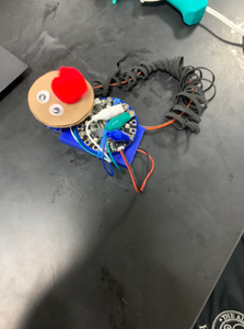

Step 15: Plug in the Battery to Make It Work
For this step of the project, students should plug in the white end of the battery into the black outlet on the CPX device. This will allow for the CPX device to successfully send the code we created to the servo which in turn will make the smiley face spin since our battery will be acting as a source of electrical energy.
Step 16: Safely Enjoy Your Smiley Face Wristband!
For this step of the project, students should enjoy their completed design! They now have an amazing, wearable wristband that includes a 3D printed component, a servo motor, a CPX device, and an adorable little smiley face. Their hard work and persistence has paid off and now they have something really cool to show off to their friends!
