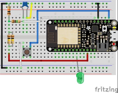

Step 1: Materials and Prototyping
  • Adafruit Feather Huzzah ESP8266 board in the configuration of your choice:
    assembled with regular headers
  • USB power supply (optional)
  • 3.7v Lipoly battery
  • USB / DC / Solar Lithium Ion/Polymer charger - v2
  • Medium 6V 2W Solar panel - 2.0 Watt
  • 3.5 / 1.3mm or 3.8 / 1.1mm to 5.5 / 2.1mm DC Jack Adapter Cable
  • 47K and 10K Resistor (for voltage divider)
  • 1 x 1MΩ resistor (optional)
  • 1 x 1µF capacitor (optional)
  • Magnetic Reed Switch
  • Plastic project box
I used a push button to simulate the door switch while prototyping.
