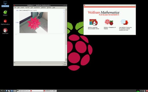

Step 3: Snap Some Pictures!
From the desktop double click the 'Mathematica' icon or type 'mathematica' in a terminal to launch the notebook interface.
To take pictures, simply run the DeviceRead command:
DeviceRead["RaspiCam"]
