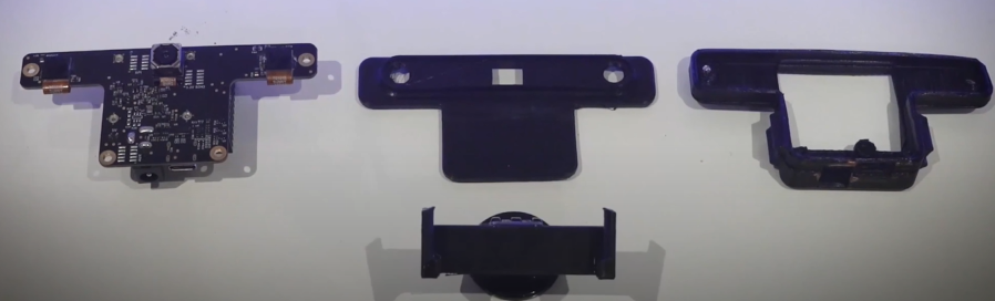

Step 5: 3D Printing the OAK-D
You can download the CAD files from depthai-hardware/User-Contributed-Mechanical-Designs.md at master · luxonis/depthai-hardware (github.com)
When you download the files, there will be multiple STL files, which you can then we can send our files to the 3D printer to print separately.
We want to ensure that we are able to mount our OAK D on a stand or tripod. Now I have modified the one mounted part to be a go pro mount rather than a quarter inch mount, so you can decide how you would like to mount it. I shall attach a go-pro tripod mount and tripod that I will link in the description for you, if you require it.
And we slice it.
I found with the OAK-1 3D printed case, the mounting areas were quite fragile, so for this reason we will use an infill of 100%.
