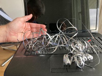

When producing the aluminum strips, they are rolled onto a strip winder first. At this moment you already have to decide which side of the soda can you want to have on the outside of your mobile .... the outer colored side of the manufacturer or the inner shiny side. The pine cones on the first picture of this Instructable have the colored side outside whereas the ball ornaments have the inner shiny side outside. Load the strip winder accordingly and finish the roll.
Then the aluminum roll is carefully removed from the strip winder. The roll is then immediately secured with tape. The aluminum roll still carries a certain mechanical tension so it will explosively unfold if you do not secure it (watch the video).

Those of you following my projects maybe remember the video how to flatten soda can sheets (Link). There we used the heat from an iron. We will use heat here also, but instead of the iron, we will place the aluminum rolls in an oven.
First, carefully remove the tape. It would not survive the temperatures in the oven. Instead of tape, wrap the aluminum roll with wire to protect the aluminium roll from unfolding.
Place the rolls in an oven for around 30 minutes at 200°C Celsius or 392 Fahrenheit. Thereafter cool the rolls with cold water. Now you can transfer the rolls to a piece of paper for drying. You will already recognize that the wire around the rolls will fall off and nothing happens.
