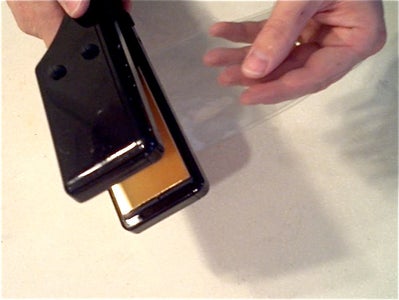

Step 3: Vinyl Bag
Lets make our bag.   I have tried a few different types of bag material.  Some include zip-lock freezer bags, vinyl, 6 mil painters tarp, and one other that I don't remember the name of.   The zip-lock did not last very long before it punctured, the painters tarp melted, the other plastic worked well but seemed prone to getting really small holes.   (If you get even the smallest hole in your bag, the sodium acetate will not stay in solution form).  So far the best plastic I have found is thick vinyl from Wal-Mart (or fabric stores).  Vinyl is cheap, available, and comes in much thicker sheets than the other plastics I have tried.
While vinyl does have its upsides, it has one major downside.   In very cold temperatures it becomes brittle.   I broke a few of my bags after using them in sub 0 temperatures.  For this reason I would like to try other types of bags.   Some types of plastic I would like to try are 1.  The plastic used in Hydration Bladders (Camelbak).  The problem is I don't know where to get this type of plastic.  2.  Silicone bags.  I am not sure how to seal this type of bag.
If you have any insights for better plastic bags I would love to hear about it.
Enough talk, lets make the bag.

1.  Clear Vinyl
2.  Metal Disc

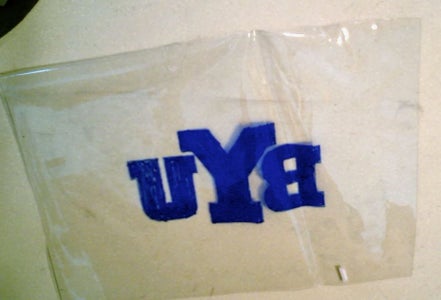

Take your vinyl and fold it in half.  Take your scissors and cut a square out of both halves of the vinyl at the same time.   Trim the edges of the vinyl to make yourself a nice looking rectangular bag.   Depending on how much sodium acetate you have will decide how large you should make your bag.  My bag was 10 1/2" by 8"

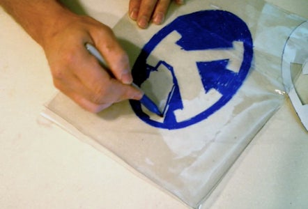

Next put your favorite sports logo or design on the inside of the bag (for me thats BYU).   If you color on the outside of the bag those colors will leach out and stain your counter when the bag is hot (even though you are coloring with permanent markers).   Draw, trace, or scribble with permanent markers a design on the inside of the bag.  Dont forget that since you are drawing on the inside you need to reverse your letters.   (It would be a good idea to test to make sure your marker really is permanent.   Draw with your permanent marker on a scrap piece of vinyl and then run it under water to make sure it doesn't come off.   I had a marker that said it was permanent that washed off when I put the sodium acetate inside).

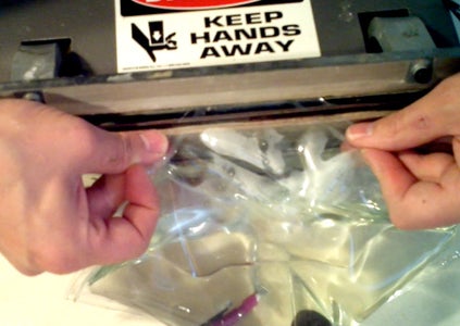

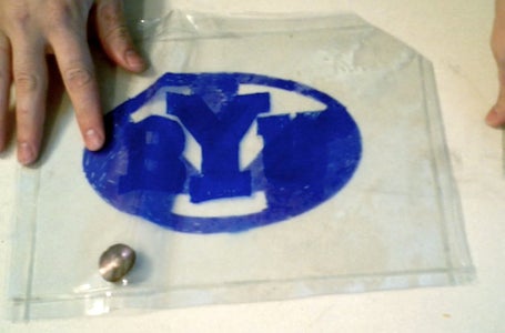

Now take your sealer and seal all four edges of the bag.  For my heat sealer I set it up to 9 seconds heat time for thick vinyl.  You will have to experiment to find the right amount of time for your vinyl and sealer.   After the 9 seconds I let the vinyl cool before trying to pull it off the sealer   If you don't let it cool you will stretch out your seam and it will create a weak point in your bag.   Note:  You can test to see if you have a good seal by trying to pull apart the seam.   If it pulls apart you didn't do it long enough.  It should tear before it pulls apart.

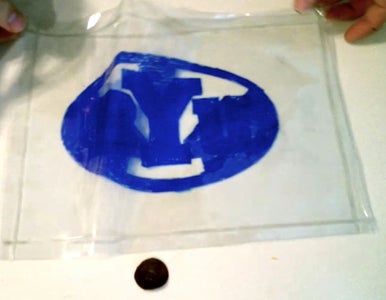

Last, cut off one corner of your bag big enough to fit your metal disc, then insert your disc.   I do it this way is so that when I add the hot sodium acetate to the bag, there is less area to seal.
If you don't have a sealer I have successfully sealed bags using a flat iron.  IF you decide to try the flat iron instead of a sealer, first don't hold me responsible if this process ruins it.  2nd, either get permission to use it (they can be expensive) or buy a cheap one from walmart.  3rd, be careful, those flat irons are hot.  I take no responsibility.   It is hard to tell how hot to make the iron in order to melt the vinyl together.   Experiment with it and come up with the right heat/time/pressure for yourself.  (As said above try pulling apart two pieces that you seal.  If it comes apart then it wasn't good enough.  You want it to rip before it comes apart).   Once you have made your bag I would recommend that you fill it with water, seal the bag, and stand on it to make sure your seals will withstand the test of time.  If it passes then cut the corner and let the water out.

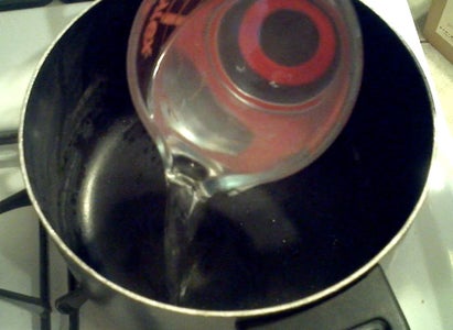

Step 4: Prepare the Sodium Acetate
Now onto the Sodium Acetate Solution.
You can either mix vinegar and baking soda in the proper proportions to make your sodium acetate or you can buy it online or at a chemical shop.  I have mixed my own before and it worked quite well but it took FOREVER and stunk the house up.   It would take a long time to make enough sodium acetate to fill a large bag.   There are a number of sources for sodium acetate such as where I bought it here -- http://www.hvchemical.com/ -- which is local to me.   I have also seen it on ebay for fairly good prices.   You want to buy Sodium Acetate Anhydrous.   We are making Sodium Acetate Trihydrate when we mix it with water.
Tools
1.  Pot
2.  Measuring Cup
3.  Tool to pound out the lumps (I used a meat pounder)
1.  Sodium Acetate Anhydrous
2.  Water
The ratio of Water to Sodium Acetate is approximately 1 cup water to 1 1/4 cups sodium acetate.    For my larger bag I used 2 cups water to about 2 1/2 cups sodium acetate.
So add your water to the pot and bring it to a boil.  Then add your sodium acetate.  Stir and pound out the lumps until everything has disolved.   At this point your solution should be near boiling and there should be a super thin crystalline layer across the top of the solution.   You want your solution right at the point where this layer appears.  You can play with the consistency by adding more water,  boiling water off, or adding more sodium acetate.
If you make the solution too thin then the heat reaction wont be as strong.  So it will still crystalize and get hot, but it wont get as hot or stay as hot as long.
If you make the solution too thick then your solution will look like a gel when cool.   It also has a tendency to form interesting crystals in the solution when it is too thick.  These two side effects can actually be pretty cool, and don't seem to change the heat reaction.

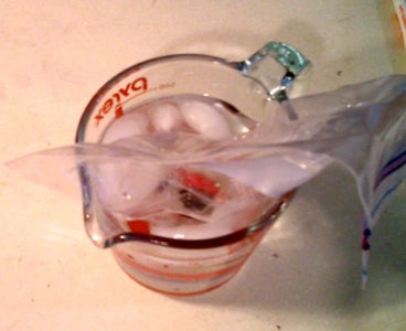

Step 5: Testing Your Solution and Activator (optional)

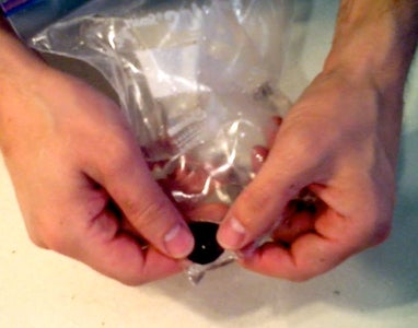

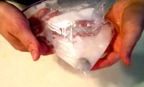

I added this step for those of you who are impatient and want to see results NOW!!!   So lets give you your results now.  Simply put we are going to create a temporary hand warmer.
Tools
1.  Measuring Cup
2.  Bowl full of ice water
1.  HOT sodium acetate solution
2.  Freezer Zip-Lock bag
3.  Clicker / Activator
Open your ziplock bag and insert your clicker / activator.   Take the measuring cup and put some of the sodium acetate solution in the bag.  Seal the bag and then place it in the ice water.   Leave it there until it has cooled off.   Once cool pull out the bag and try out your clicker.  INSTANT HEAT.   USUALLY.    Sometimes the clickers are temperamental and take a little more effort in order to activate your solution.   If needed click, twist, and/or bend your activator until you get the reaction to take place.

Step 5, Any sodium acetate in the area of the final seam (crystalized or not) will prevent a good seal.   When you seal the bag the water evaporates and the sodium acetate crystalizes in the seam.   I prevent any problems by wiping out the seal area with a wet paper towel.   Simply wet a paper towel and wipe the inside of the bag where the seam will go.   Make sure to do a good job cleaning the inside of that seam.
Step 6,  Force any excess air out of the bag  (making sure not to get sodium acetate in the area of the seam, a little air is ok) and seal the final seam.
And thats it, your bag is done.   You might put your bag in cold water so that you can cool it down and try it out.   Often times after you initially seal the bag the solution will crystalize and you will have to heat the bag up in boiling water to melt all of the crystals before testing it.

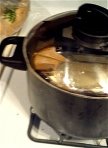

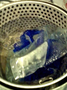

Step 7: ReHeating the Body Warmer
To reheat or reactivate your body warmer all you have to do is boil it.    Essentially what your trying to do is melt the crystals.  Sodium Acetate Trihydrate  (what me made with Sodium Acetate Anhydrous and water) melts at 58 C or 136 F.
Tools
1.  Pot of boiling water
2.  Strainer
3.  Tongs
Fill your pot will water and heat up the water.   Add some sort of barrier into the pot (a strainer, or a rag).   The barrier is to prevent the vinyl from sticking to the bottom of the pot and becoming too hot and melting.   Next add your bag to the water and put the lid on the pot and let it boil for a while.    You need to let it boil past the point where you can see any crystals (even little tiny ones).  Finally once it is all solution again take it out with your tongs and let it cool.
You can help speed up the melting process by taking the bag out of the pot and mixing the solution in the bag around.  This helps to distribute the heat inside the bag.
During the boiling process you can test the solution in the bag to see if it is completely melted by taking the bag out of the water and hold it up by one corner.   Then using a pice of ice cool down the corner of the bag you are holding.   If the solution crystalizes in that corner then it is not ready to take out.
