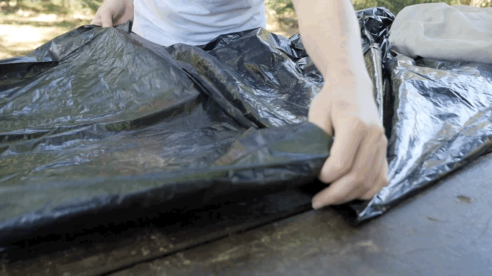

Step 2: Trim Bags
Leave one trash bag with the bottom seam intact, then cut off both the seam and the flaps (if any) on two more bags. On the last bag I cut off the seam, but not the flaps, since they'll be at the opening of the balloon (however flaps are not required).

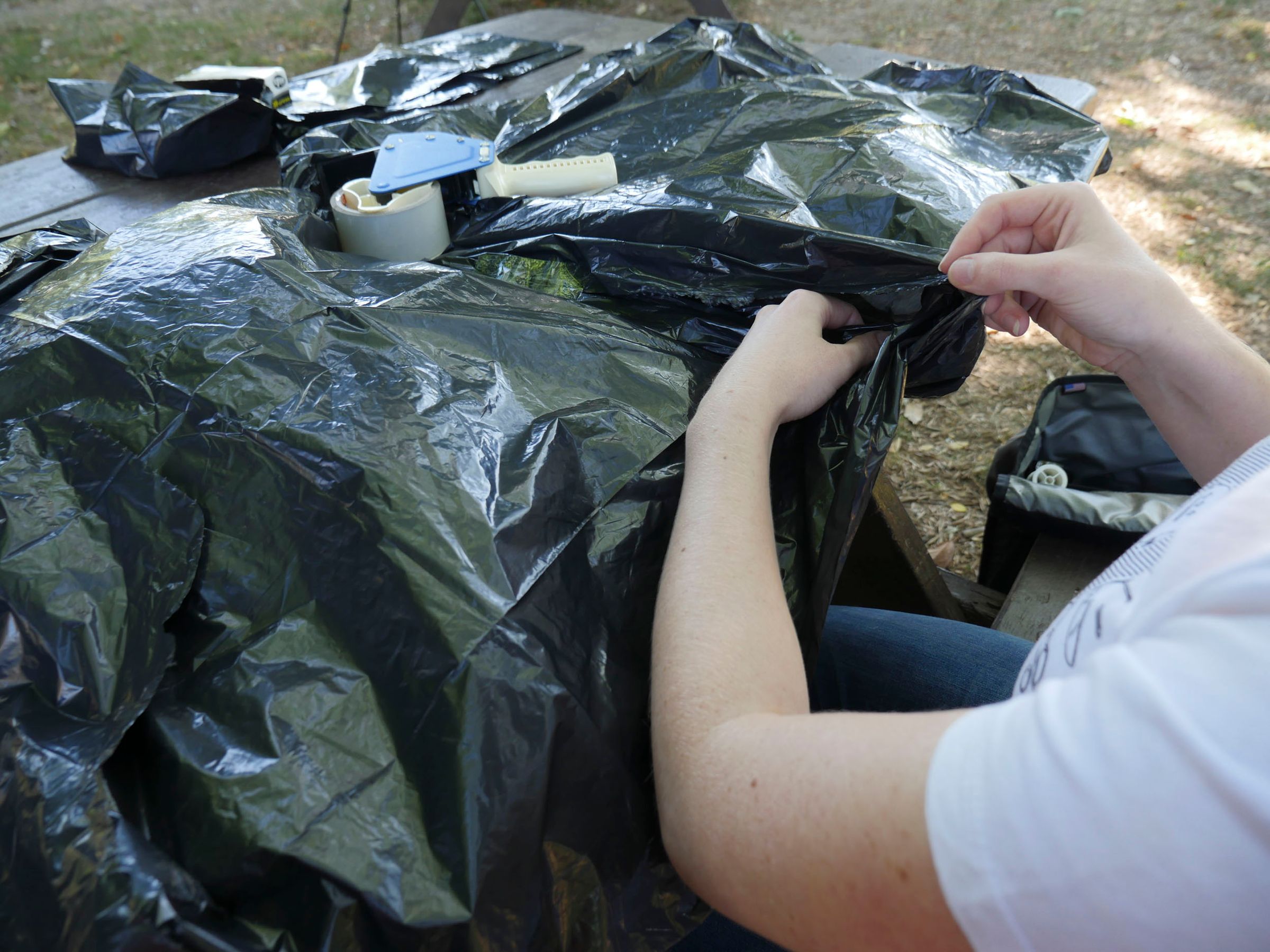

Step 3: Tape Together
Open up and overlap the trash bags together by about an inch, then tape around each seam.
Make sure you don't have any gaps or holes.Step 4: Inflate Your Balloon

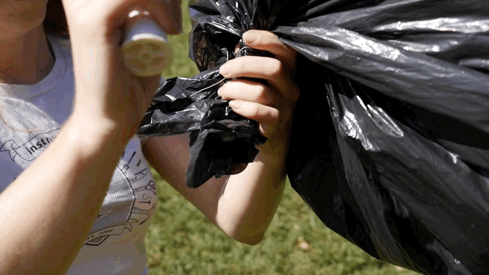

Run around to fill your new balloon with air.
Gather up and tie off the open end of the balloon, topping it off with air from your lungs (if you're up to it) or a hair dryer (optional).
Tie a knot in the gathered end to close up the balloon.
