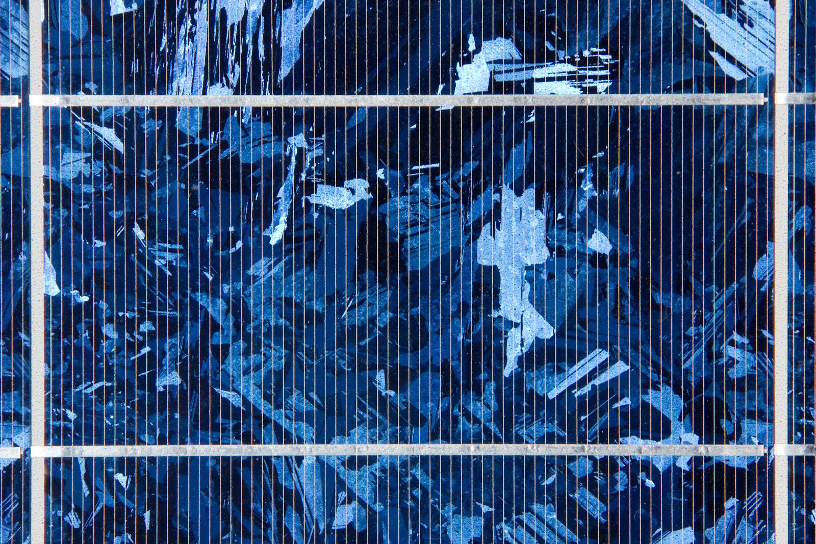

A solar panel is made from an array of photovoltaic cells, which generate an electrical current when exposed to light. Photovoltaic cells are made from two types of silicon semiconductor stacked together in wide flat layers sandwiched by a solid conductor on back and thin gridded connectors on the front (so light can directly contact the silicon).
The photovoltaic effect was discovered in 1839 by French scientist Edmond Becquerel, and by the 1880s, the first solar cell. The material used was selenium, which had been recently discovered to have photoconductive properties, which means it becomes electrically conductive when exposed to light.
Another 1880s observation catapulted solar technology forward: the photoelectric effect. Light hits a surface of a material and the photons knock the electrons out of place, freeing them to flow through a conductor. But it wasn't until the 1950s that more-efficient silicon was used in commercial solar cells, and it remained so prohibitively expensive that its applications were limited mainly to satellites.
Research steadily improved solar power's efficiency and reduced cost. Modern solar panels are made from crystalline silicon with two types:
- n-type silicon has an excess of electrons
- p-type silicon has a deficiency of electrons
Photons hit the layer cake and electrons are knocked out of their spot at the n-p junction. They are then free to move through the top conductors and into a circuit.

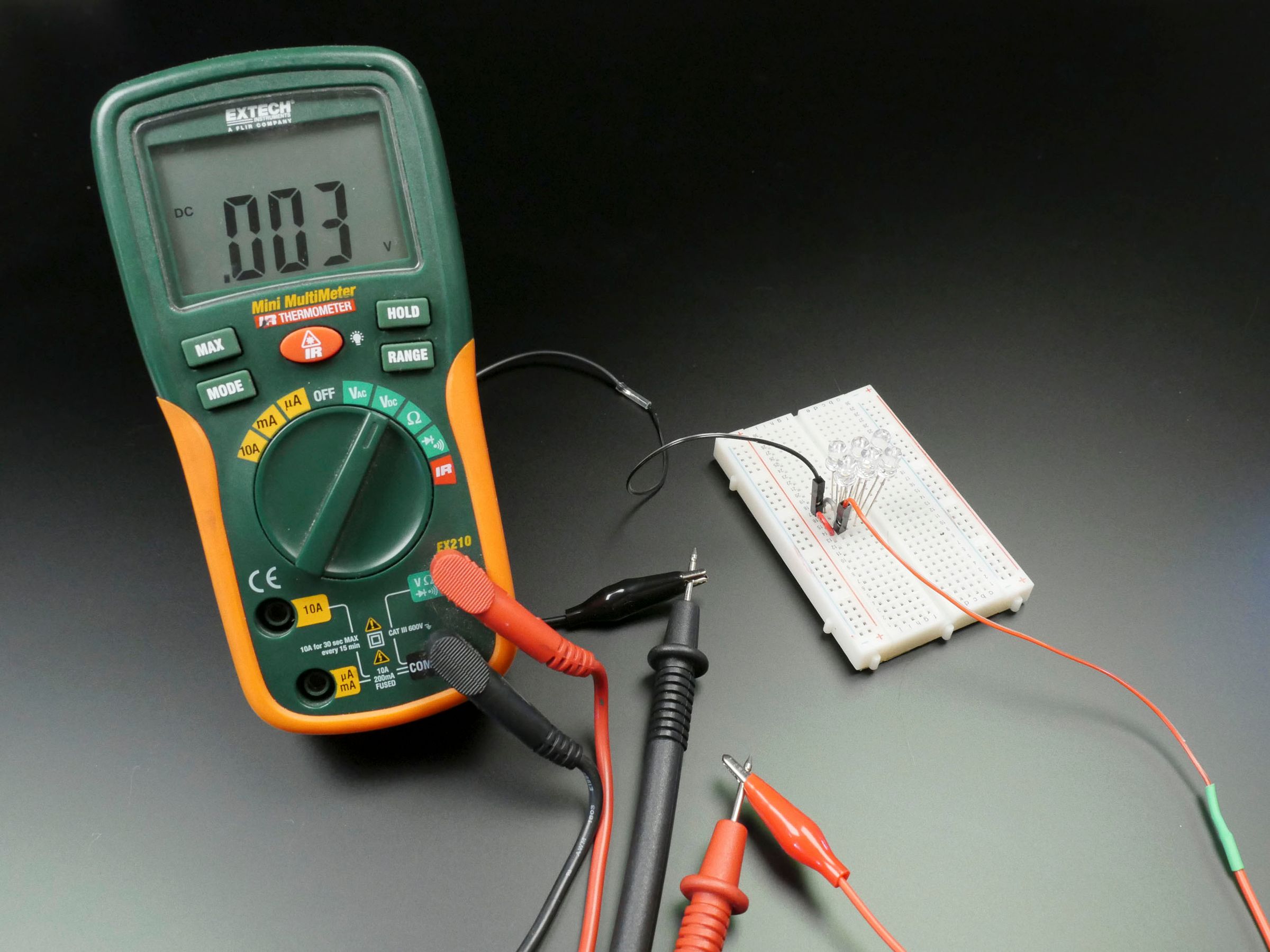

You can perform a fun experiment to demonstrate this effect with a few LEDs, a solderless breadboard, and a multimeter. LEDs are diodes, which are also made of two types of silicon layered together to allow electron flow in one direction. They behave similarly to photovoltaic cells (but much less effective at generating power), and we can measure the electricity they generate. Learn more about diodes in Randy's Instructables Electronics Class.
Wire up a handful of LEDs (6-8) in parallel on a solderless breadboard.
Attach the probes of your multimeter to the positive and negative terminals and measure the voltage. Alligator clips can be handy here to free up your hands. Shine a bright light on the LEDs and watch the voltage increase!

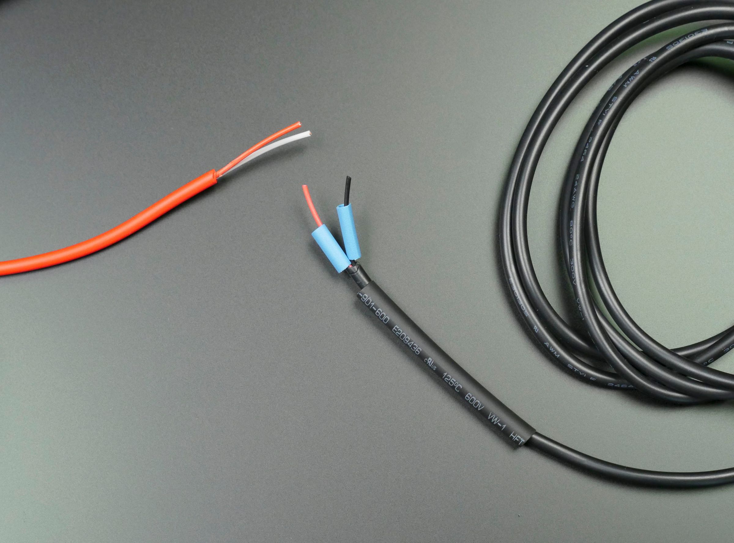

You may wish to extend or change the connector on your solar panel's wire. Here's an effective way to cleanly splice the cable to install a different connector and/or extension. make sure you're using wire that is the appropriate thickness/gauge for the maximum current of your solar panel.
Apply a large piece of heatshrink tubing over the slack of the wire. Strip and tin the inner wires, and apply smaller bits of heat shrink to one side.
For the cleanest end result, cut the wires asymmetrically as shown. Solder the inner wires, matching red to red and black to black (or white to black as in my case), then heat up the heatshrink tubing to insulate the solder joints.
Repeat to insulate the entire junction with the larger piece of heatshrink tubing, and you can hardly tell there was any wire surgery!
