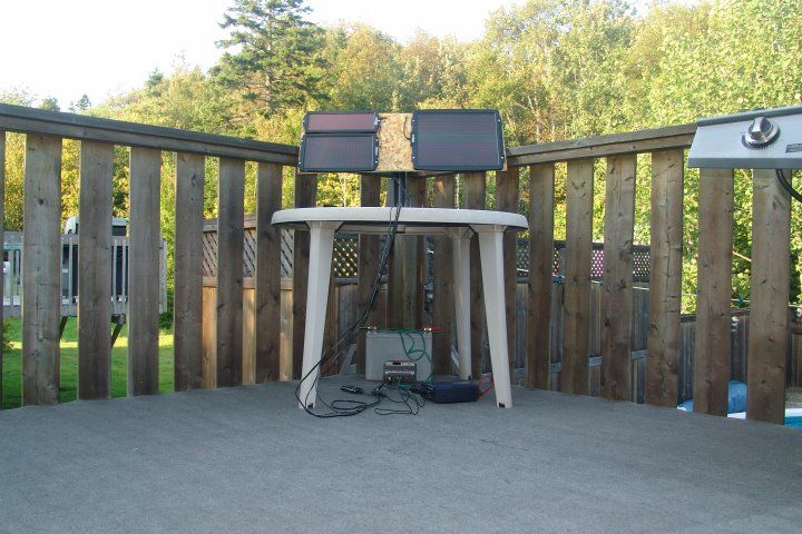

Step 4: All Together
The battery takes about 2 to 3 days to fully recharge and it can fully mow my lawn with battery capacity to spare about 50%. In this picture you can see I have two solar panels connected to the removable battery. The two solar panels are electrically separated so there isn't any risk of the a short circuit. If I use the two solar panels the recharge time is about a day and a half.
