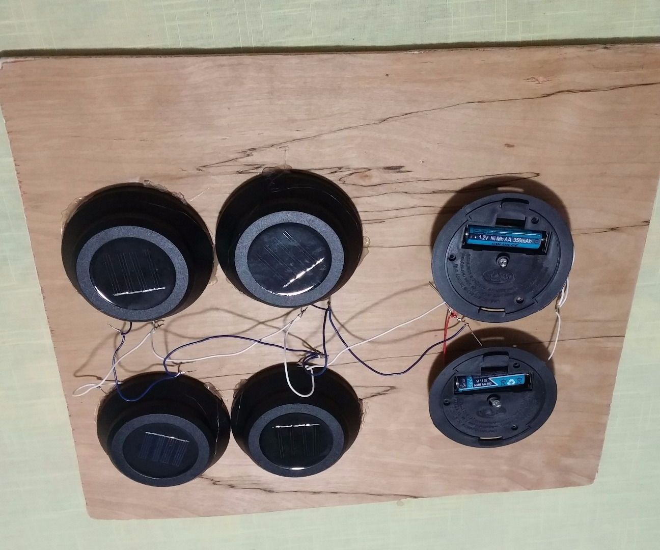

Step 3: Solder Wire (A) to Positive (+) Side of Battery on Solar Lamp #1
Cut the wire to a length of 8 inches.
Strip 1/4 " off both of the ends of the wire and thread it thru a hole in the solar lid.
Using the soldering iron, solder this wire to the positive (+) lead of the battery on the first solar lamp.
Step 4: Solder Wire (A) to Negative (-) Side of Solar Lamp #2
Thread the other end of the wire thru the solar lid of the second solar lamp.
Using the soldering iron, solder this wire to the negative (-) lead of the battery on the second solar lamp.
Step 5: Solder Wire (B) to Negative (-) Side of Solar Lamp #1
Cut another length of wire to a length of 12 inches.
Strip 1/4 " off both of the ends of the wire and thread it thru a hole in the first solar lid.
Using the soldering iron, solder this wire to the negative (-) lead of the battery on the first solar lamp.
Step 6: Solder Wire (C) to Positive (+) Side of Solar Lamp #2
Strip 1/4 " off both of the ends of the wire and thread it thru a hole in the second solar lid.
Using the soldering iron, solder this wire to the positive (+) lead of the battery on the second solar lamp.

Step 9: Solder Wires to DC Booster
Using the soldering iron, solder the other end of wire (D) to the positive (+) IN of the XL6009 DC booster.
Solder the other end of wire (B) to the negative (-) IN of the XL6009 DC booster.
Cut two more 12 inch lengths of wire and strip 1/4" from both ends using the wire strippers.
Solder wire (E) to the positive (+) OUT of the XL6009 DC booster.
Solder wire (F) to the negative (-) OUT of the XL6009 DC booster.
